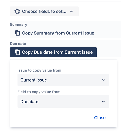

However, I still have two individual date fields in operation A, which I want to copy to operation B.
Do you have a sample for the syntax?
Many greetings,
Chris
Tessa Tuteleers
January 4, 2023
Glad you got it working!
Datefields normally can be copied natively, by using the "choose field to set", and then copy and choose the origin field.
Kindly mark the answer as accepted so other users can find the solution if they need it. :)
- Tessa
