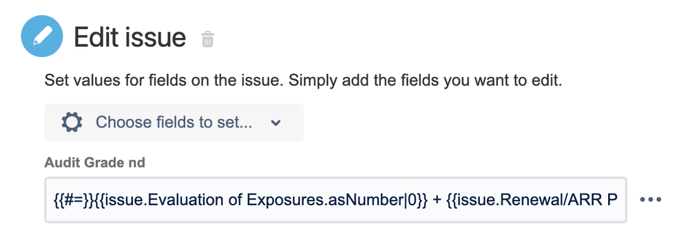

@Stefan Salzlthere are only two elements to the automation at this point:
  • A scheduled trigger using a jql query: issuekey = UWADT-1504:
  • An Edit Issue action with my target number field identified as the field to modify with the script in question populating that field:

Bill Sheboy
May 6, 2022
Here is one hypothesis: fields for addons which dynamically generate values cannot be used in smart value expressions other than as a simple read due to the order of operations.
How to test that: write {{issue.Evaluation of Exposures}} to the audit log and see if it has a value.

Rick Crow
May 6, 2022
@Bill Sheboy Update. For grins, I used your test and wrote both {{issue.Evaluation of Exposures}} and {{issue.Evaluation of Exposures nd}} (the modified, non-dynamic field). As expected, the first one returned significantly more than the field value and the second one returned the value of 3. I then modified the first one to {{issue.Evaluation of Exposures.value}} and it then also returned the correct value of '3'. But neither approach is yielding a correct sum from the automation.
Rick Crow
May 6, 2022
@Bill Sheboy Update: using either {{issue.Evaluation of Exposures.value}} (Deviniti dynamic selects) or {{issue.Evaluation of Exposures nd.value}} (standard select fields), I'm now getting a valid sum.
Finally then, I've modified the script to divide that sum and I'm now good!
{{#=}}({{issue.Evaluation of Exposures nd.value}} + {{issue.Renewal/ARR Pricing nd.value}} + {{issue.Communication to Agent nd.value}} + {{issue.Issue Instructions/Renewal Pricing Sign Off nd.value}} + {{issue.Risk Grouping nd.value}} + {{issue.Deductible nd.value}} + {{issue.Claims Information nd.value}}) / 7 {{/}}
Thanks for helping point me in the right direction.
