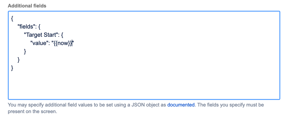

This is what I am trying to do, and it says the value must be a string. How would I set the value of Target Start to the present day?
Curt Holley
November 1, 2021
I haven't ever used Target date, but I'm wondering if you need to prescribe the exact date format for the field.
Work that out then have a play with some inspiration form Use smart values to manipulate and format dates | Jira Software Cloud | Atlassian Support
Julia
November 2, 2021
Turns out this has been raised to Atlassian and they're gathering interest. Target Start can't be set because it comes from Portfolio for Jira

Curt Holley
November 2, 2021
Aha
@Julia that makes sense...though other such fields (Team) can be used, if somewhat hamstrung.
Anyway, simple solution. Create your own date fields (or use other existing if available) and use them.
