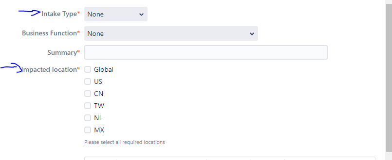

We have two custom fields
1. Intake Type (select list)
2. Impact Location (checkboxes).
When a user select option from select list ( ex: network), and if one option is selected on checkbox (ex: US) a issue related should be created in another project (name : Infra project). If the user select two options two issues should be created, if three options selected three issues should be created and if the user select (ex: Global option) a total of 5 tickets should be created in Infra project.  IT PROJET ERROR.PNG

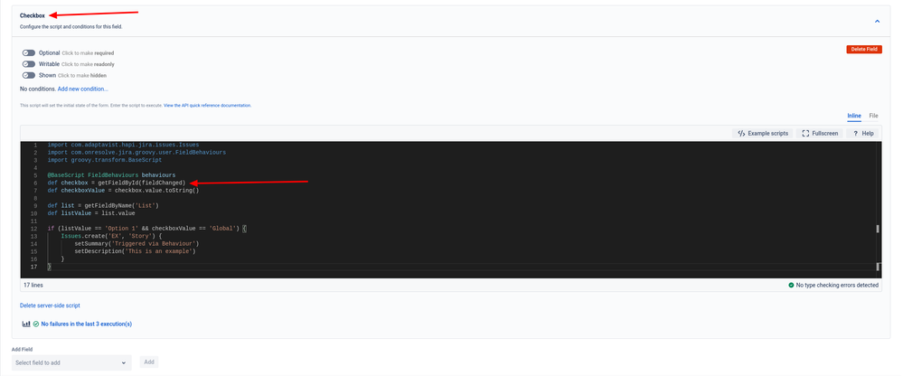

2. Server-Side Behaviour code for the Checkbox:-
import com.adaptavist.hapi.jira.issues.Issues
import com.onresolve.jira.groovy.user.FieldBehaviours
import groovy.transform.BaseScript
@BaseScript FieldBehaviours behaviours
def checkbox = getFieldById(fieldChanged)
def checkboxValue = checkbox.value.toString()
def list = getFieldByName('List')
def listValue = list.value
if (listValue == 'Option 1' && checkboxValue == 'Global') {
Issues.create('EX', 'Story') {
setSummary('Triggered via Behaviour')
setDescription('This is an example')
Below is a screenshot of the Server-Side Behaviour configuration for the Checkbox:-

If you observe the codes provided for the List's Server-Side Behaviour code, the List is initialised as:-
def list = getFieldById(fieldChanged)
 Similarly, for the Checkbox's Server-Side Behaviour code, the Checkbox is initialised as:-
This is required to identify which field makes the change.

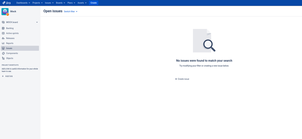

1. When the is started, both the Mock and Example projects are empty without any issues, as shown in the screenshots below:-
