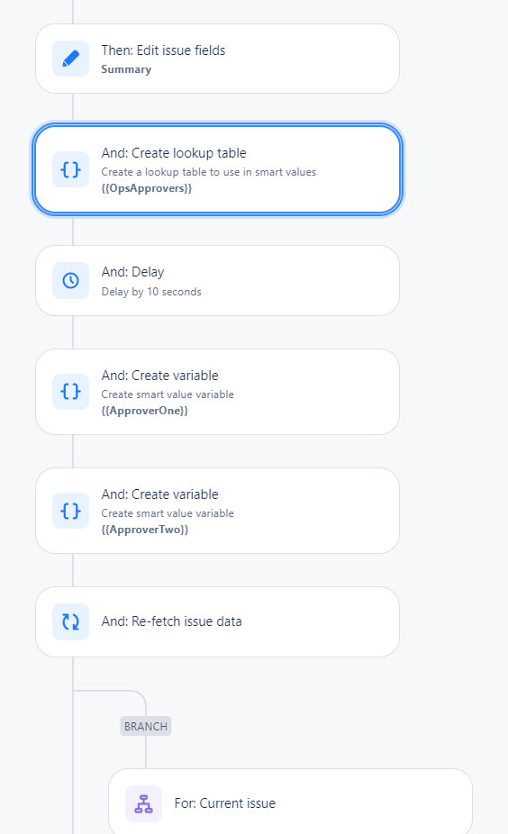

The automation should: (steps not working correctly notated in bold. imgs 1&2)
   -Use the custom field with the radio button to edit the summary.
   -Create a lookup table (users vs userID)
   -Delay for 10 seconds to allow this step to complete
   -Create two variables (lookup against radio select value and provide the userID)
   -Re-fetch issue data
   -Branch and set two custom user fields using the variables
-Comment the variables on the ticket as a check they are providing the correct data.

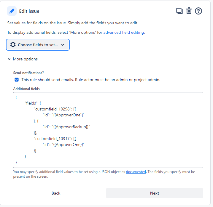

I keep getting the error "data was not an array" when trying to set the approval fields.
I have tried:
   -asJSONobject, .asJSON, .asJSONarray in various places in the lookup table, variable,
       and edit issue.
   -update/add/set etc.
   - "accountID"/"id"/"" prefacing the user ID string
   -adding .accountID, .value, "value" to the edit issue
   -multitudes of other solutions provided through atlassian but haven't been able to resolve.
On another ruleset, I have been able to edit these custom fields when amending one of the fields to {"id":"{{reporter.accountID}}"}, but that's already a smart value.

First for that error, that may indicate your JSON is incorrect for the fields.  If they are multiple-selection user fields, then the array syntax is needed: https://support.atlassian.com/cloud-automation/docs/advanced-field-editing-using-json/#Multi-user-picker-custom-field

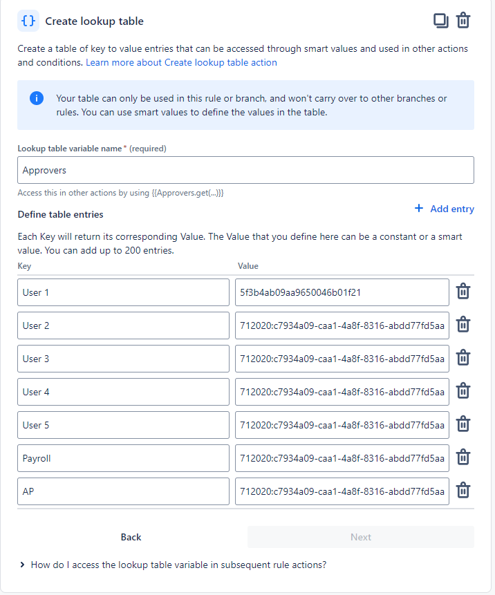

For the create of the lookup table, the Values for your user accountId values should not have double-curly brackets around them.  They are not smart values as they are only text.

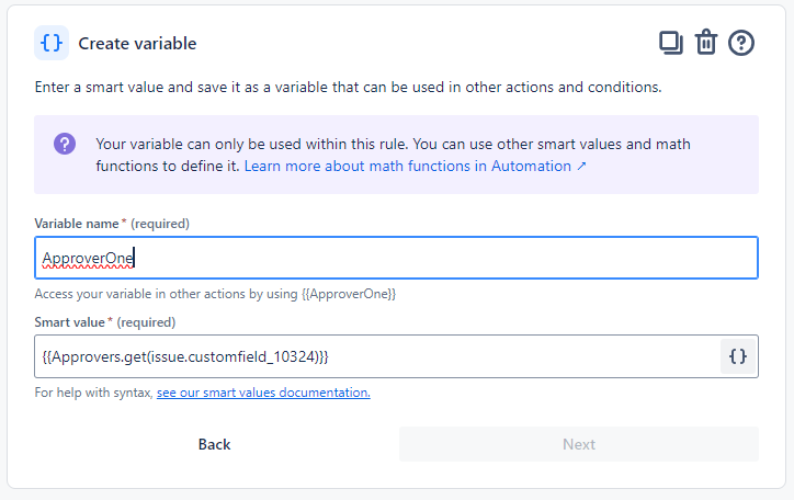

Next, created variables are plain text, without any structure.  And so you cannot later access an attribute such as accountId, as you try to do for {{ApproverOne.accountId}}  Instead, do that when the value is set.  (See below...)
Finally, when you are looking up the value in the lookup table, I suspect your customfield_10324 is a single-selection, user field.  Is that correct?  If so, please change the variable create to:
{{OpsApprovers.get(issue.customfield_10324.accountId)}}

Both custom fields I am trying to change (10298 and 10317) are multi-select user fields.

Field 10324 is a single select dropdown field that shows on the intake form as radio buttons.

Updated to this and IT WORKED!
{"fields": {
       "customfield_10298": [{"id": "{{ApproverOne}}"}, {"id": "{{ApproverBackup}}"}],
       "customfield_10317": [{"id": "{{ApproverOne}}"                                              }]

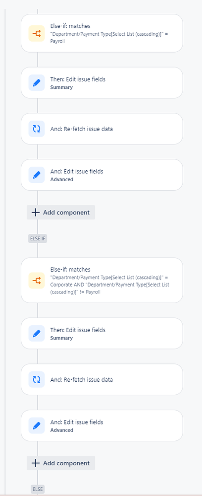

The steps required and appropriate user to make the approval is dependent on the input. (Complicated because invoices which bypass expense approvals are handled in another system, so an end user can't enter an approver for that step as it's not needed). We also need the ability to send requests back to the beginning and request updates which wipes out all approvals and allows changes to be made to the request.
Automation
Lookup Table
Create Variable
{{issue.customfield_10324}} is a dropdown field and is populated by the reporter submitting a form.
