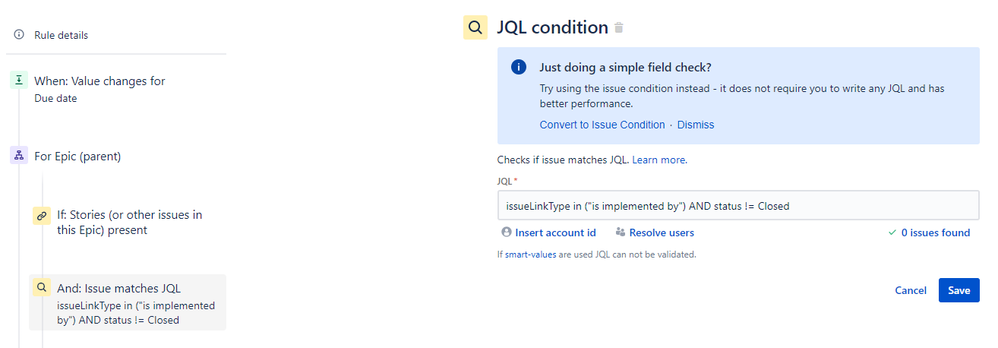

HI
I'm only familiar with the Cloud version of Automation, but ignoring my trigger/insert whatever trigger is relevant....wouldn't something like this work? plus no scriptrunner functions required.
