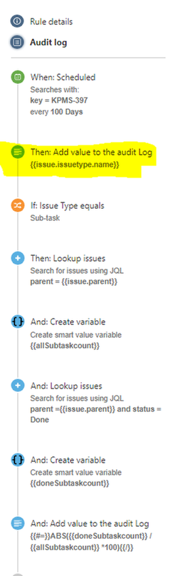

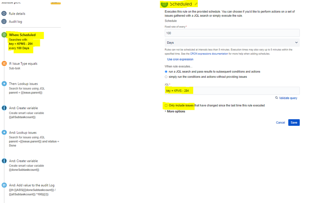

Lets try a different thing just to confirm rule is going to get triggered.
Change your trigger from "Issue Transitioned" to "Scheduled Trigger" and in the JQL section on same screen, give a sub-task key which we will use to test. Like I have below screenshot. Notice the highlighted section, make yours like I have..
So change trigger, go to that sub-task and change it from In Progress to Done and share the audit log.

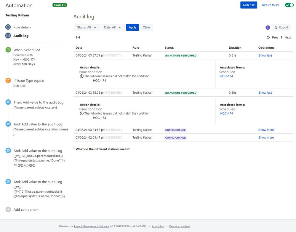

@Kalyan Sattaluri I have did what you asked and highlighted shows that it is pulling from that subtask and added the logs, I had changed the status twice from in progress back to done and ran it to show the same function happening.

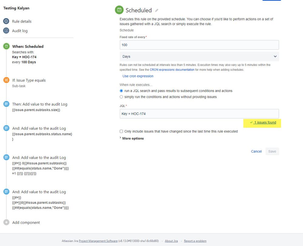

Your screenshot had the previous rule running that I do not have lookup functionality. I just wanted to remind you since we got so many screenshots haha! I do really appreciate you helping me and sticking with this. This is very kind of you!

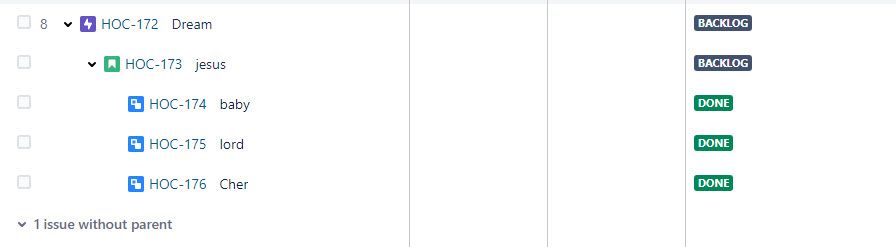

Is HOC-174 a sub-task? Cause from the audit log it does not look like it.
Please replace it with a sub-task and transition that sub-task.

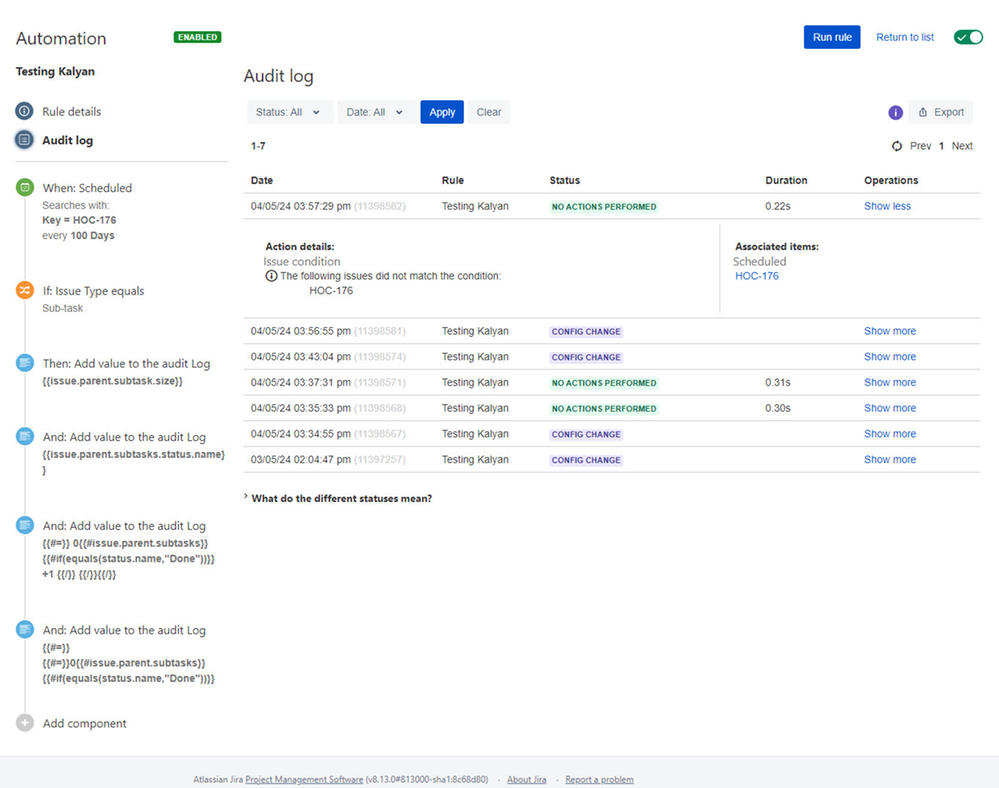

It is a sub-task, I will change it to Cher hoc-176 and here is the log. I have changed the key to Cher then published it then went to hoc 176 cher then changed it to in progress to done then I pressed run rule button. I want to explain the steps I did to see if I did anything wrong! =D
Hmm, something's strange. One last thing, can you, before the If condition, add another log statement to check if HOC-176 is called sub-task or something different in your set up?
So, log {{issue.issuetype.name}} like I have in my screenshot, right after the trigger, run the rule and share screenshot..
Hey @Kalyan Sattaluri !
So I got a screenshot with a success but tell me if it looks good. I see a issue condition that does not recognize hoc-176. I hope we are making progress! =D
Hello @Jonathan Chatfield
I honestly am not sure why your "If condition" is not passing the check.
You may need to check with someone in your company on why thats happening as what I was sharing is expected behavior.
Either you are in a really old version of automation with bugs in software or there is something wrong with how your issue types are configured.
So please try to check in with someone in your company and share them this rule and ask why we cant get past the first If check.
I knew your logic had to be correct, so I relooked at my if: issue condition and there are two Issue types selections from the dropdown menu to choose so I chose the other one and got an actually log it looks like! What else is there?

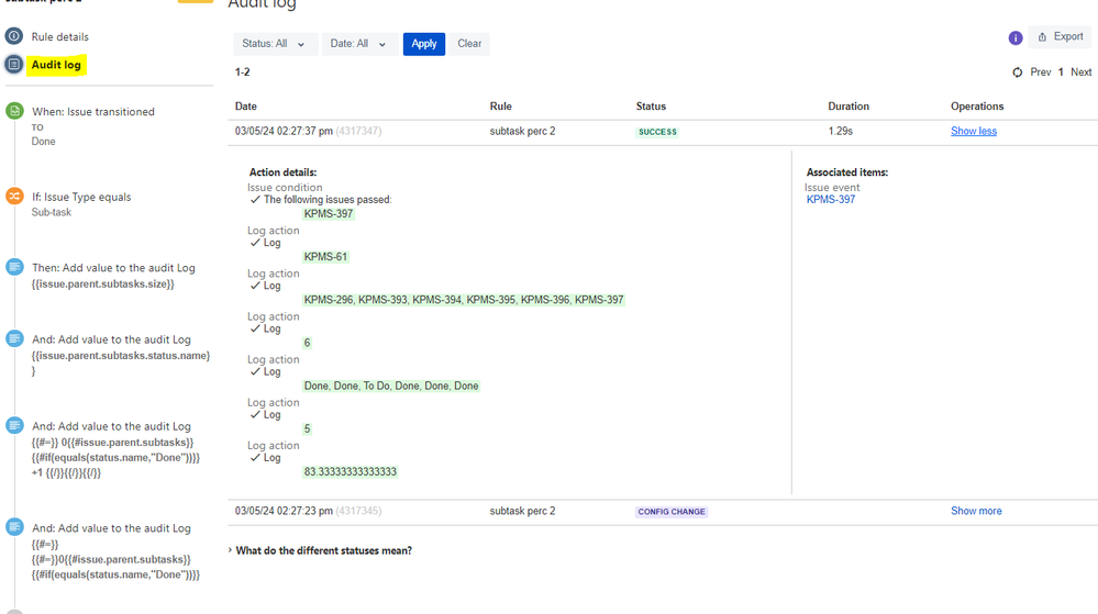

There is a typo in one of your log write smart values: subtask should be subtasks:
parent subtask count: {{issue.parent.subtasks.size}}
I recommend adding prefix text to log entries like this to confirm which value is logged.
Bill
Hello @Bill Sheboy
Thank you for spotting that! I looked into the log and see where that section didn't have information! That is good to know for future references for checking!!
After seeing that mistake, I went back to the code you previously sent and it seems to be working. I look forward to hearing your next steps to make this happen. I really appreciate all your help and this guidance is helping me understand what I need to type in these fields for the future! =D

Just FYI & I should have explained it earlier itself- the last log statement we did was to calculate the % of done. That is:
{{#=}}{{#=}}0{{#issue.parent.subtasks}}{{#if(equals(status.name,"Done"))}} +1 {{/}}{{/}}{{/}} / {{issue.parent.subtasks.size}} *100{{/}}
We will be using the above syntax as part of our check.. Hope you have tested with various combinations of sub-tasks in different states so you can check the % done calculations. If not, please do at this point.

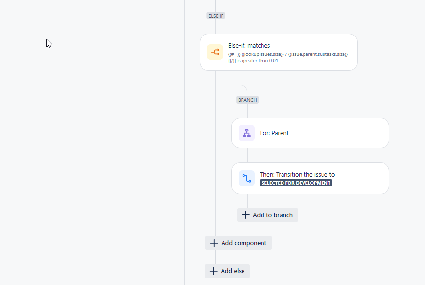

Now, the next steps, its just a series of If/Else and branch statement.
I am going to list steps how your rule should continue, take a look at below set up, and modify according to the statuses you want...
So, After your last log statement, you will do:
Add Condition -> If/Else Block:
NOTE: the first check of "To Do" applies only for first case, for the rest of the else statements you dont need the status check . You can just check % done and transition.
MORE IMPORTANT NOTE: If you have transition workflow restrictions on story, that is, unless "Acceptance criteria" is filled in, you cannot go to "in progress" or similar, your rule will fail.. so you need to handle that after branch but before you transition the issue by doing Edit Issue and filling in the fields or whatever is needed to satisfy the transition...
I have included a first condition of the screenshot, you just need to include based on your requirement.
So, given first step is done, From here on, you just keep adding additional else clause and "additional conditions" for next series of checks you want to do. Should be straight forward.
So try to implement the same, play around with your requirements and make sure your If conditions are tight. That is, earlier we gave % done is less than 50, and we made it "in progress", next, give a specific range of % Done is greater than 50 and less than 75%, if so, transition to "testing server", equal to 100, transition to "Done"...
Its just a matter of testing all scenarios thoroughly. So try it and let us know.

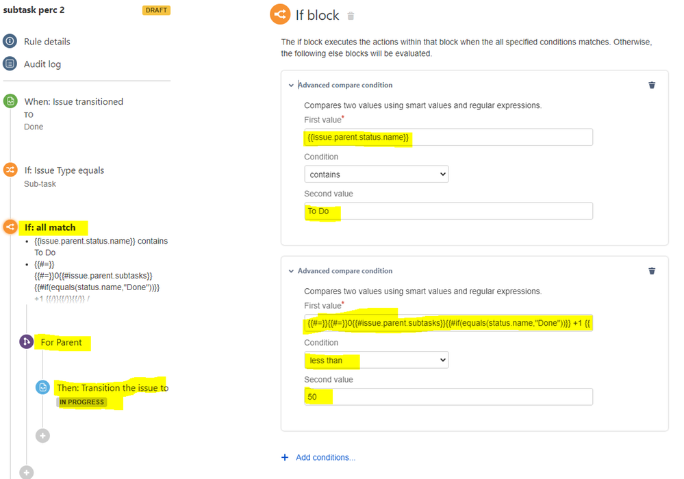

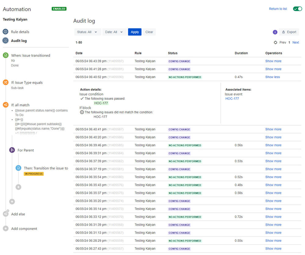

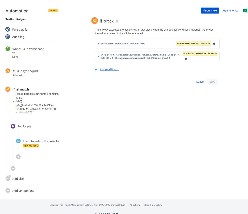

I feel like I typed everything like you did but there is something wrong with my If since I see the If block is saying did not match condition. Here is the code that I wrote:
{{issue.parent.status.name}}
Contains
To Do
Less than
50
Am I doing something wrong? Also I am attaching the main story screenshot as well just to show that I did 25%

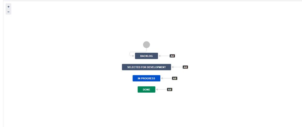

Your HOC-166 story initial state is "BACKLOG".
so change first If condition to:
Earlier it was To Do, because thats what I have as my initial state of story. So please take care of your status's names.
Awesome, It works! Thank you for all this help @Kalyan Sattaluri
 I had to type Backlog and boom it all worked! I did a 50 percent In Progress and a 100 percent transition to Done status for the story!

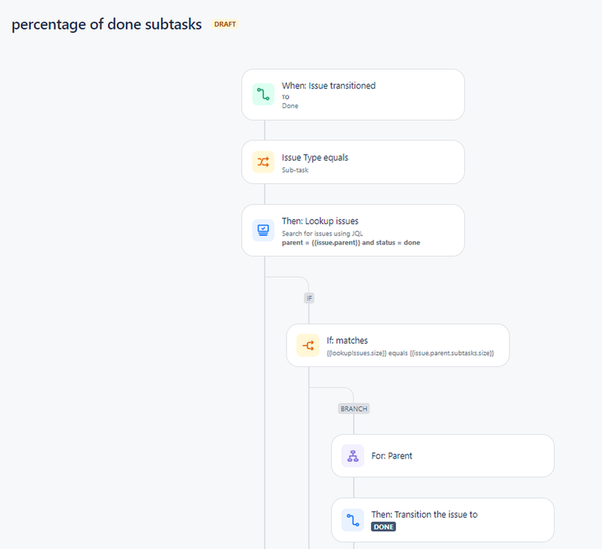

Hi @Jonathan Chatfield - welcome to the community,
I suggest the following:
whenever a subtask is set to done the rule should run and check for all subtasks in the story. This will be done with a lookupIssues (collect all done subtasks within the same parent).
then going through the options with if-else conditions calculating the percentage of done subtasks and transitioning the parent via parent-branch.
see the screenshot below (I just took the status I have in my system - need to be changed according your requirements):
Hope this was helpful. Let me know if you have any further questions.
