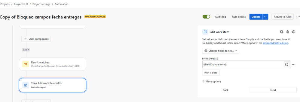

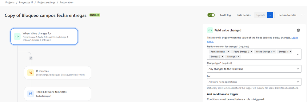

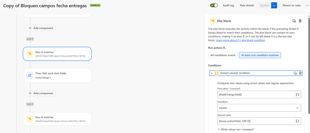

I'm struggling with an automation and I hope you can help. I have 3 date fields and 3 text fields. What I'm trying to do is prevent them from editing the value after entering data.
Currently, I've only managed to keep the data and return it to the original value if they enter something. Then I set up conditions based on "IF" and "ELSE" to go through all the fields, but now it doesn't do anything :(
I've attached images of the rule so you can better explain what I built and help guide me toward a solution.error automation3.pngerror automation2.pngerror automation1.png

What I managed to do was "revert" the value of the modified field to the original. While this doesn't comply with the concept of "locking" as such, it helps users know after the announcement that after entering a piece of data once, they won't be able to change it again.
The problem started when I added more fields because it recorded the first changed field and then copied that original value to another field that had been modified, from the list of fields we specified.
