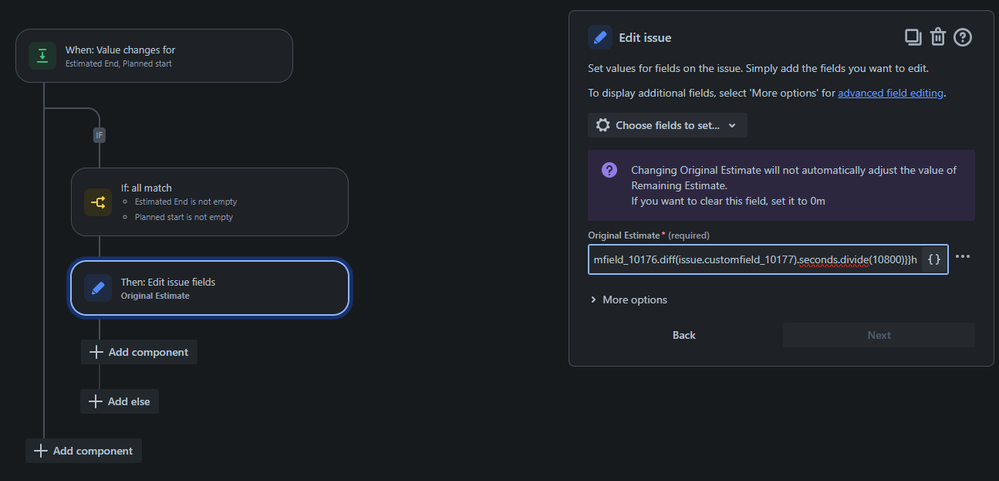

Here is a final overview of my rule:
Thank you for the help, have a great day!
