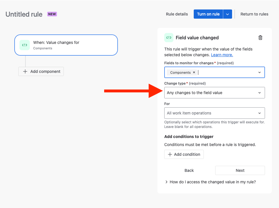

Hello @rachel rutti
You should see that as part of the Trigger:
If you are not seeing that, please provide a screen image of what you are seeing.

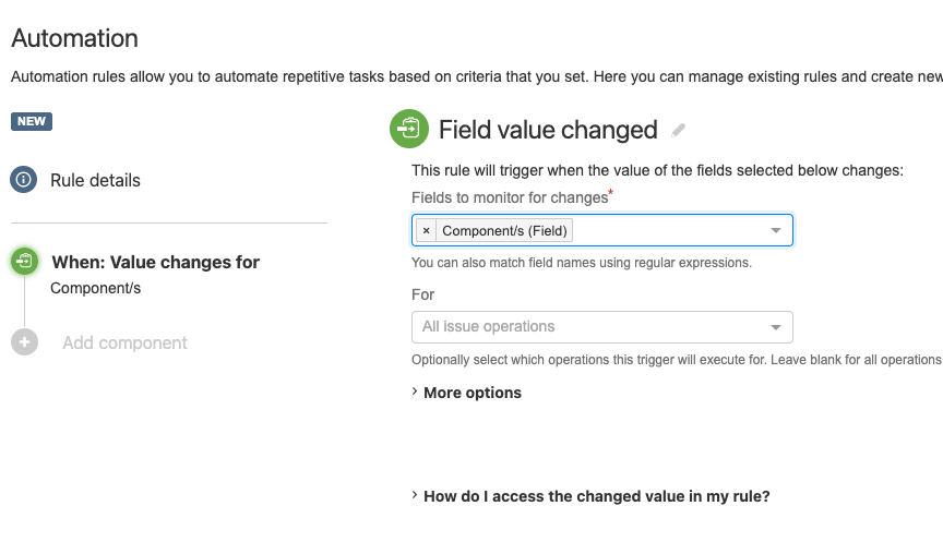

Does your screen otherwise look the same as mine? Do you have the same icon showing for the trigger? I ask that to try to confirm that you are actually working with Jira Cloud. If you are working with Jira Data Center the available options are different, the screen looks different, and the icons look different. The option is not available in Jira Data Center:

...we concluded that you were using Jira Data Center. So you are likely seeing something like the second image I provided, and you won't have the option to specify "value added" as part of the trigger.
It will be very useful if you include that information in any future questions you post.
