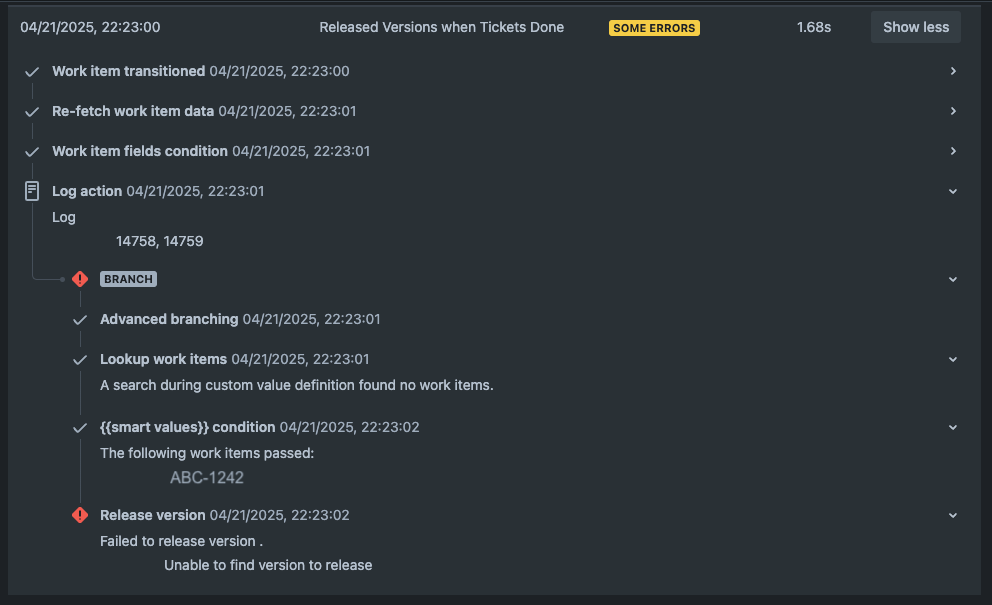

Heather, would you please post an image of your current complete rule and of the audit log details showing the execution (with all of the areas at the right side expanded)? That context may help explain what you are observing. Thanks!

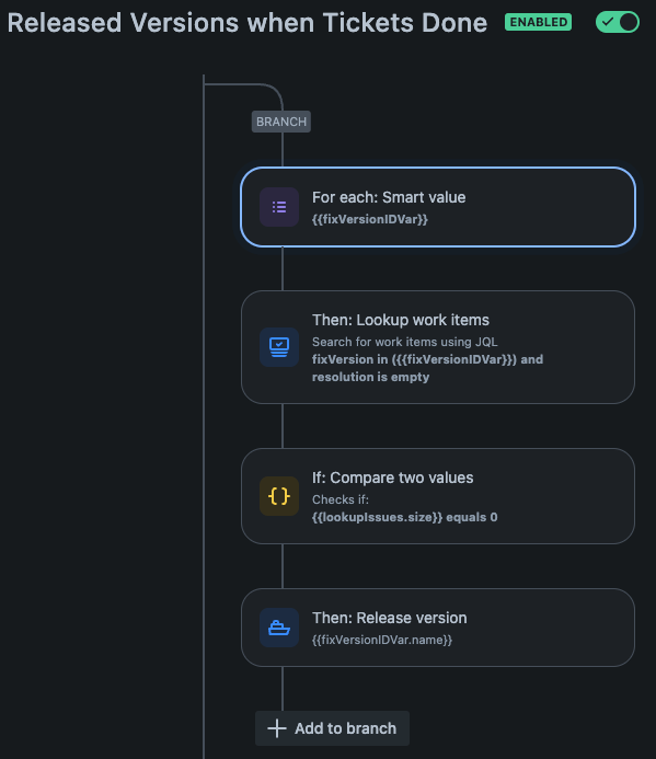

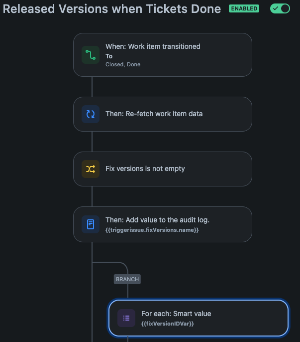

@Bill Sheboy @Andrea Robbins Here's the rule in its current state. I hope this helps. I haven't touched it since we last spoke.
Thanks for the rule image, and let's adjust some things...
First, smart values are name, spacing, and case sensitive, and the one for the Fix Versions field is {{issue.fixVersions}} so please update your log statements and the advanced branch.
Next, let's simplify the branching and only use the ID values (as those will be needed later for releasing. Thus for the advanced branch smart value, we can use the new flatten function to combine the values (from the lists-of-lists) and get the distinct ones:
I added ID to the variable name to make it obvious what value it contains. Then change the JQL for Lookup Issue inside the branch, and follow that by a condition to confirm no issues remain. Please note well: the JQL was missing the NOT to confirm there are no remaining issues active in the version.

@Andrea Robbins I noticed that you have other steps in the automation branch that aren't in your screenshot. Am I missing other steps? I am getting new errors now. Now we can't find the release version at all.
I think we got it.
This is the final rule for anyone else that needs it. Thank you so much @Bill Sheboy and @Andrea Robbins
