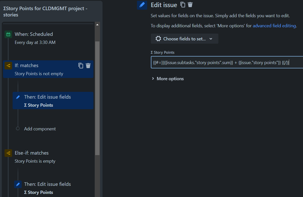

Now sub-tasks is easy. We are able to leverage the subtask smart values and pull out the story points, we then just have to sum them up and Hey presto. However, you have to take into consideration if the main story also has story points. So using conditions you can separate out what the actual sums are. I created a new custom field in order to story the story point of the actual ticket plus the roll up value.

As you can see from the screenshot above. We use a similar structure to handle the different circumstances, look up the values and then edit the custom field with the lookedup values.
