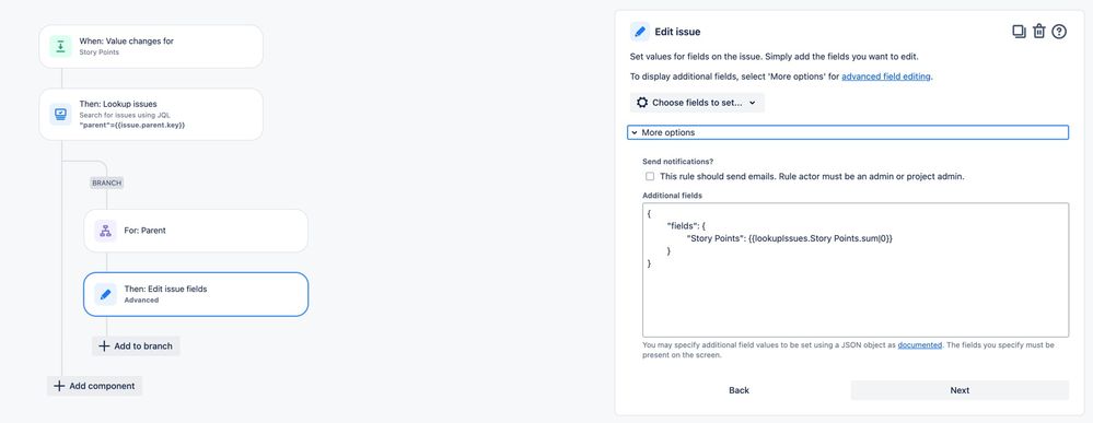

Hoping someone can help with next steps to get story points from Epics summing to the parent Odyssey after the initial 'Sum up story points to Epic' action has occurred.
I've already set up an automation to sum story points from tasks to epics using the template from the library (Sum up story point estimates in Epic) and that is working. Can I add another action the then sum story points from Epics to Odysseys and how would I do this?

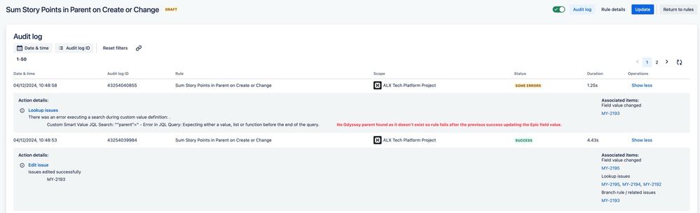

The only issue is when no Odyssey parent exists, the rule still runs and updates the Epic but then fails as it can't find an issue key for an Odyssey, which means a lot of rule failed emails are starting to come through.
Is there a way to add a condition that checks the parent issue key is not blank?

You don't actually need the Lookup Issues action in your rule. It doesn't serve any purpose. If you remove that there will not be an error recorded for the rule execution. It will still be triggered, but the Branch command will recognize that there is no Parent issue and the status of the rule will be "No Actions Performed".

I tried removing the Lookup Issues action, and now the rule appears as successful however the actual field value on the parent does not update with the new story point total. Actually it looks like it's setting the story points value to 0.
This is the JSON object I'm using from the Template automation:
"fields": {
"Story Points": {{lookupIssues.Story Points.sum|0}}

You do need the Lookup Issues because you are using that to get to the sum of the child issues.
You can move the Lookup Issues action to be within the branch instead of before the branch. Then it will only be performed when there is a parent for the trigger issue. After moving it, change the JQL to
parent={{issue.key}}
Within the branch {{issue}} will refer to the parent issue rather than the trigger issue.

That worked! Thank you so much for all your help I really appreciate it!
