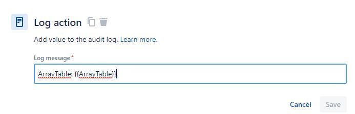

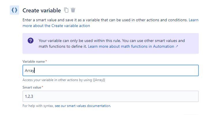

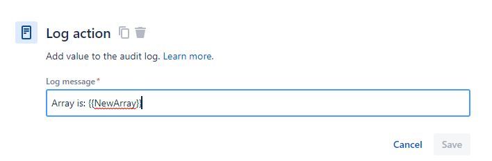

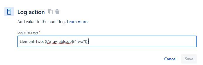

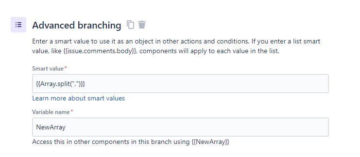

It seems after a while I was able to solve this issue. Bellow is the example of my Automation rule. This Automation is getting a list from 1,2,3, ... string variable.
1. Set a manual trigger
2. Then create a variable
3. Then add value to the log
4. Then make additional Log
5. Then create Advanced branching
6. And finally log action again
As a result, you'll get this:
Even More you can continue with the new available smart-value called lookup table
1. At first this
2. Then Log action
3. And finally access your table
Hope it helps!

Bill Sheboy
April 16, 2023
Hi @Slava Gefen
Thanks for your suggestions.
As I noted to you in my other post for the open backlog/suggestion item on created variables...that does not help in this scenario as the advanced branches are executed asynchronously and non-deterministically.  The scoping issues would prevent usage of the accumulator result.
And...I can confirm that although the new lookup tables help with some things, they also cannot by iterated over as an alternative.
My understanding from Atlassian people is that eventually created variables will be typed/objects; when (if?) that happens split lists can be referenced by other than {{.}} to enable more complex use cases.
Bill

Slava Gefen
April 16, 2023
Hey @Darryl Lee
I think I even tried splitting "1,2,3,4" into its own variable, hoping it would "magically" convert to a list, but Automation did not like that.
I was able to split 1,2,3 string variable into a map. Please look at am answer above.
