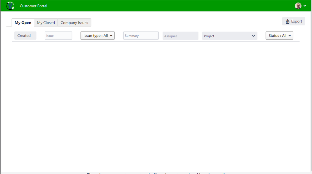

As I am new to Atlassian products, I don't know if this is expected behaviour, but we have a customer that says he used to have a search bar in Customer Portal under the My Issues section that is no longer available.
Attached is my own view, which also does not have the search bar. Is this normal or a bug?

Thanks for the reply Charlie. We are running Jira version 8.5.3.

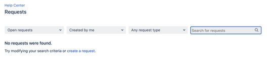

I've had a look at an instance we have here at Atlassian which is running JSD 4.5.3 and the search bar looks quite different to the one in your screenshot:
I suspect that you might be running an older version of Jira Service Desk (3.16.x or 3.9.x) than the equivalent to Jira 8.5.3. As you can see from our Marketplace listing for Jira Service Desk, it's advisable to run the matched JSD and JSW versions. The team tells me that it is possible to run JSD with a newer version of JSW but it isn't advised.
It would be worth finding out what version of Jira Service Desk you are running and if it is out of sync with the Jira 8.5.3 that you have I'd suggest you look into upgrading so you can benefit from the improvements we've made to JSD since the 3.X versions, which will include the additional search field on the customer portal.
