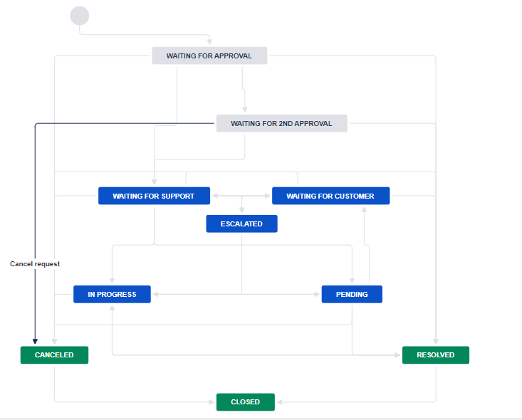

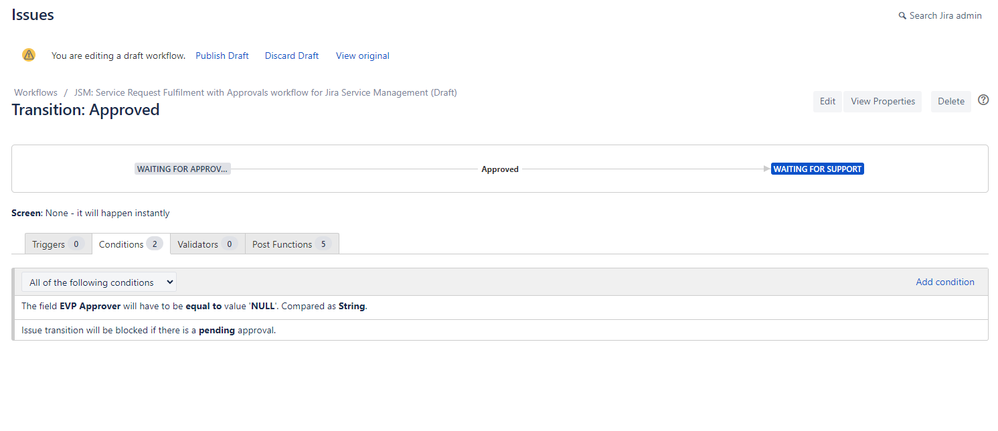

Yes, the transition out of Waiting for Approval is where I am having issues.
I created a custom field called EVP Approver. When the user selects a Printer in the form, the EVP Approver field became visible and required. The user now must select the EVP approver before submitting the ticket.
There are 2 "approved" transitions out of the Waiting for Approval Status
I created a test ticket and have the printer selected and picked the EVP Approver. When the 1st approver hits approve, the issue immediately transitions to Waiting for Support ( instead of Waiting for 2nd Approval as I hoped for).
So I checked the approval step config within the Waiting for Approval status and saw that you must pick your transition when approved. I am not 100% sure but this seems to bypass all the conditions I have set above. Maybe I didn't set something correctly? Thx

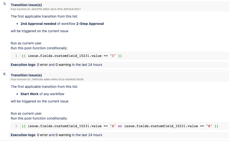

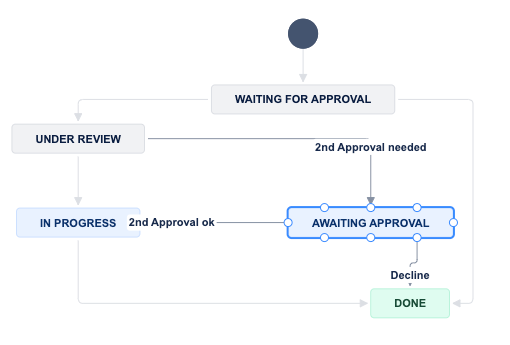

@Duc Anh Le as promised I tried several things and came up with a solution supported by the app JMWE.
My workflow uses sample statuses, please don't mind the wording. Key is that there is a status in between the two approvals. This one will always be auto transitioned over, but we need to have a step for handling of the device selection.
Glossary
Approver 1 = Approvers
VP = Budget Manager
Device = Selection
Workflow:
The 2nd Approval step has just the same simple logic as the first one, but with another user picker field, here Budget Manager
Here are some screenshots of the workflow and post functions. Hope this helps. Please feel free to ask again.
