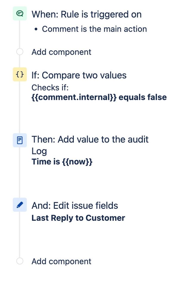

Yep I was following that route and got the automation set up ok

Here is the automation rule I used in case anyone needs it Last Reply to Customer is a custom field
