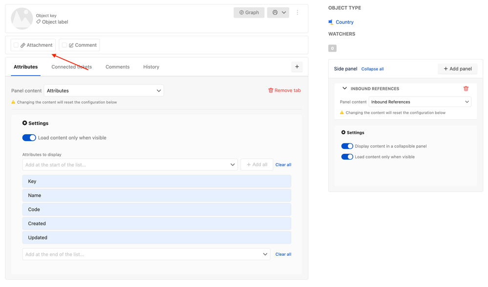

Geoff Mether _Togetha Group_
February 21, 2023
Hi @Jeroen Poismans and @Justin Deutsch
I've been looking at this issue and I can't replicate what you are doing Jeroen. I've tested with a Manager that does the configuration and a Developer that can create/edit the objects.

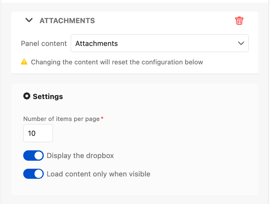

As part of the layout configuration changes, I removed the attachment button and the attachment Panel. I'm wondering if you missed the removal of the attachment Panel Jeroen? - it isn't specifically mentioned in the article.
For those interested (future me ;-) ).
To remove the attachment button, uncheck the box next to it.
To remove the attachment panel, select the bin in the top right.Attachments panel.png
When I do the above, I can't see how I can make an attachment. I'd appreciate anyone letting me know if they can still add attachments.

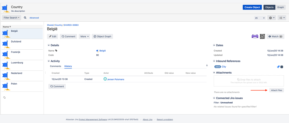

Jeroen Poismans
February 21, 2023
Hi @Geoff Mether _Togetha Group_ ,
Thanks for digging deeper into this!
What I have done here on a different OT so I don't have to blur out everything, as you can see I removed everything Attachment related in the page layout:
Then returning to the object search and selecting the Detail view, you can see while the Drag n Drop might be grayed out, the button to Attach files is still enabled and allows to select and upload files (logged in with a Developer role):
And it actually gets attached:
Jeroen
