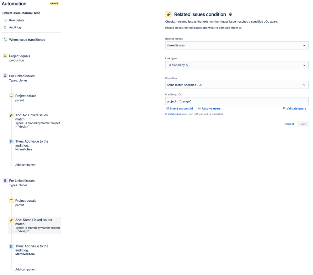

Hi there @Oto Tabares,
Developer from Automation here.
Depending on your exact setup it might be possible to get the following rule setup to work. I've made a few assumptions with the below examples but it might be able to solve your use-case using a combination of linked issue branches and JQL.
We will need something to link the primary issue in parent with the other issues in design and production, so in my case I assume that design and production tasks have an issue link of "clones" to the parent task. Provided your cloned issue have use some type of issue links then you should be able to achieve the below examples.

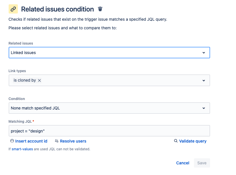

To do this I would create 2 rules, one which handles the case of a design issue syncing changes to parent and the second having production make changes back to parent as well. Statuses are linked to issue transitions so you'll need to set that as the triggering event, then attempt to edit/transition the parent issue depending on what you want to happen. You might be able to get it all working in one rule but I think two helps simplify this.
Screen Shot 2021-11-18 at 9.53.46 pm.pngScreen Shot 2021-11-18 at 10.00.23 pm.png
For the second rule you'll need to duplicate this one but change the design project in the conditions to be production. I've added a log action in the example but once you've got it working you can change that to something like edit issue, or transition issue copying from the linked issue if you would like to sync statuses. The related issue conditions with one using some and the other using none will help match the cases that the item is created in one of the sub projects but not in the other.
Since it uses checks in multiple projects the rule will either have to be set as global, or the project scope including the projects used projects.
It's a bit of a complex use-case for Automation so it might not suit your exact requirements, but you can also reach out to support here: https://support.atlassian.com/contact/
Cheers.

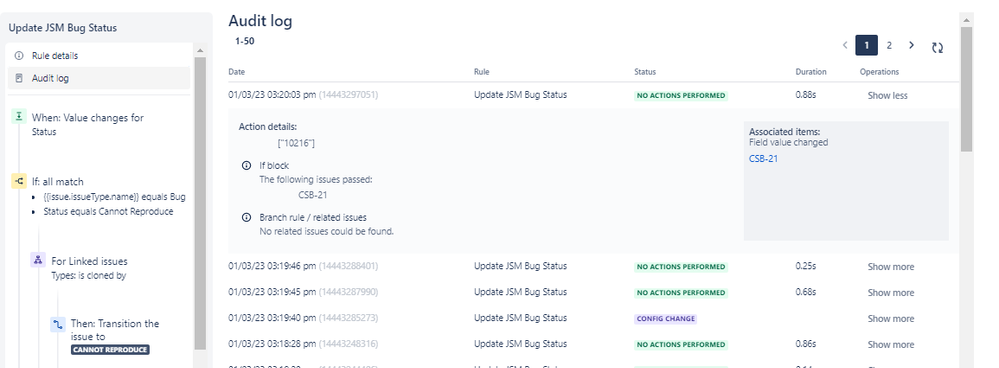

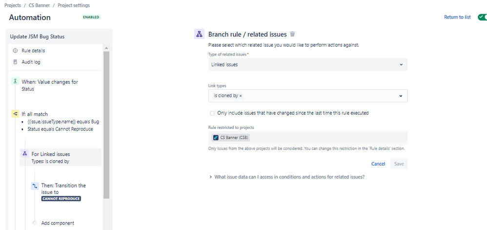

yerriswamy s
March 1, 2023
Hi @Yvan Martin
I tried the same way as like below to change the status of linked issue. is cloned by or clones link types are now working.
But I get below error saying "No related issues could be found".
I have created a issue in JSM and the same cloned into JIRA software project, now I want to change the status of Issue in JSM as same as Cloned issue.
Please help me out on this
