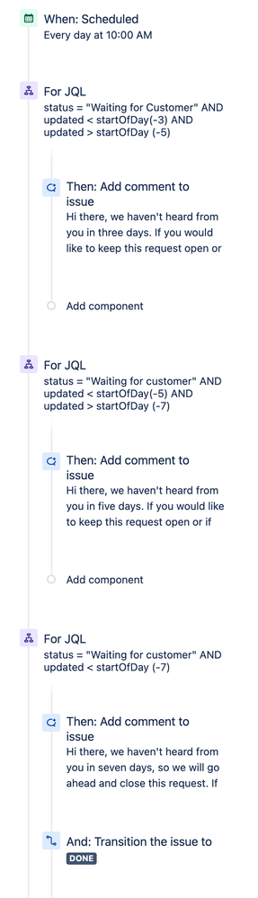

Here's the current configuration. There are three automations, each scheduled to run every hour. Here are the queries for each one:
The 3-day notification works. The 5-day also works, but not until 5 days after the 3-day notification when I need it to be 2 days after the automated notification (the original 3 + 2 more days). The same is happening for the 7-day, of course.

Hey there! Thanks so much for the detailed reply. I tried implementing a version of this yesterday (screenshot attached) and scheduled it to run this morning. It posted the comments it should have. However, it "reset the timer," and the queries are validating against zero issues now. I think this is because the automation's comment on the issue is counted as the last comment.
So, it seems there needs to be some way to exclude the automated comments so that the queries are only based on the last customer comment. Is that something we can accomplish through the JQL?

As for your query, it did not give the intended results. i.e., it was returning issues that had been updated within the last three days. The only way I could figure out how to get the intended results was with the queries in my screenshot (inspired by your suggestion). Now I just need to figure out how to get the automation to ignore it's own automated comments.
