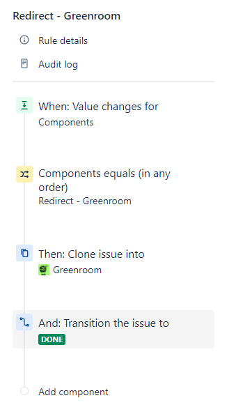

    I am trying to create an automation that when a component is selected, a ticket gets cloned and then the trigger issue gets closed. What I can't decipher is, based on the screenshot I've attached, is this going to transition the trigger issue or the cloned issue to closed?  Thanks.

Hi @Ben Weisman This should transition the TRIGGER issue to Done.  The clone issue would only transition if you added a branch.
