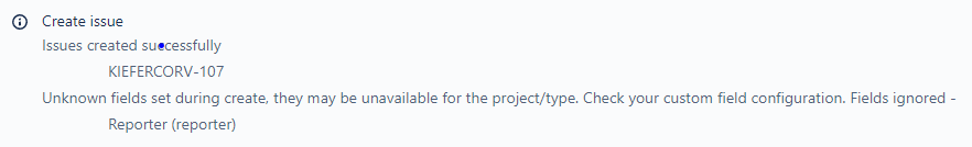

Can someone help me with the error in the screenshot? This automation is generating a sub-task whenever a certain task type is created. I have it set to just copy the reporter from the trigger issue. Not sure what this error means or how to fix it.

Hi @Ben Weisman - Can you share a screenshot of the create issue action?

Something else that comes to mind... Are you using Automation for Jira as your actor?  If not, does the actor have modify reporter permission?

Ah, I was using 'User who triggered the action'. I've adjusted that as it makes sense since those people can not adjust the reporter!
