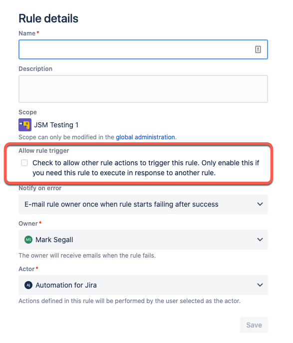

Hello, I'm trying to create an automation that whenever a certain sub-task type is created, it is automatically given a time estimate.
The automation appears to be working EXCEPT when the sub-task was created as part of another automation. Why is that the case? Is there a solution?
Example:
Task 1 is created.
Automation kicks off to create a sub-task under it.
Second separate automation to put a time on this sub-task any time it's created is not happening.
Thanks.
Mark Segall
February 23, 2022
Hi @Ben Weisman - By default, automation rules will not trigger from other rules.  You just need to click the "Allow Rule Trigger" checkbox on the Rule Details screen.
