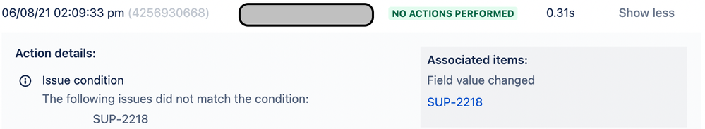

Ticket is being created, Request participants are being set up properly according to alias after ticket creation but automation is not meeting the conditions.
No idea why it's not meeting condition. Anyone can see something wrong here?

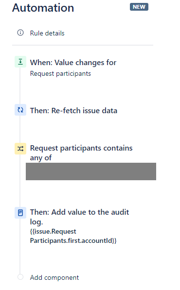

Hi @szymon_szostak
if you like you could test the following rule.
No guarantees given but I could imagine a timing issue. Also, at least there should be a log afterwards telling what Jira sees for the "Request Participant" that time:

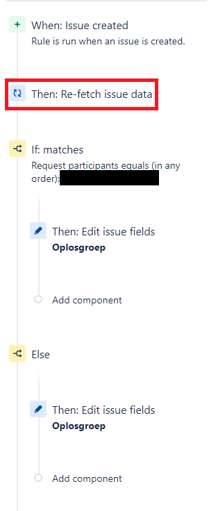

@szymon_szostak
This solution also solved our problem with the: "When: Issue created" trigger.
Looks like that "Request participants" is filled after the ticket creation.
"Re-fetch issue data" will fix this.
This is our Rule:

February 10, 2025
Thank you @Daniel Ebers Re-fetch issue data solved my automation based on participants!

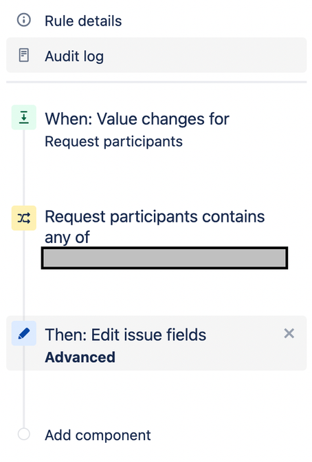

Hello @szymon_szostak
Welcome to the Atlassian community!!
You have an interesting use case, one which I have never tried before. I sent an invite to the email id which was required to be confirmed and created the below rule which is working as expected.
I would suggest sending an invite to the mail id 'product.support@company.com' and then try.

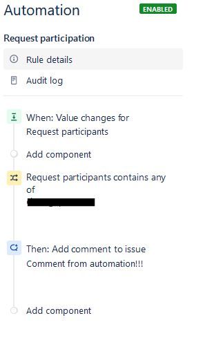

szymon_szostak August 9, 2021
Hi! Thanks for answering.
I have added incoming mail with alias at first place. Looks like automation is triggered correctly, but somehow, it's showing that conditions are not met.
Hi, thanks for such quick response.
This is strange - I really think this is some kind of issue with order of things going on during the issue creation. When the mail comes, it creates a ticket and then it's adding the request participant. I believe it's somehow triggering it before it saves the participant.
I've done some test where I changed the trigger to work on update and I was changing the priority - it worked like a charm.

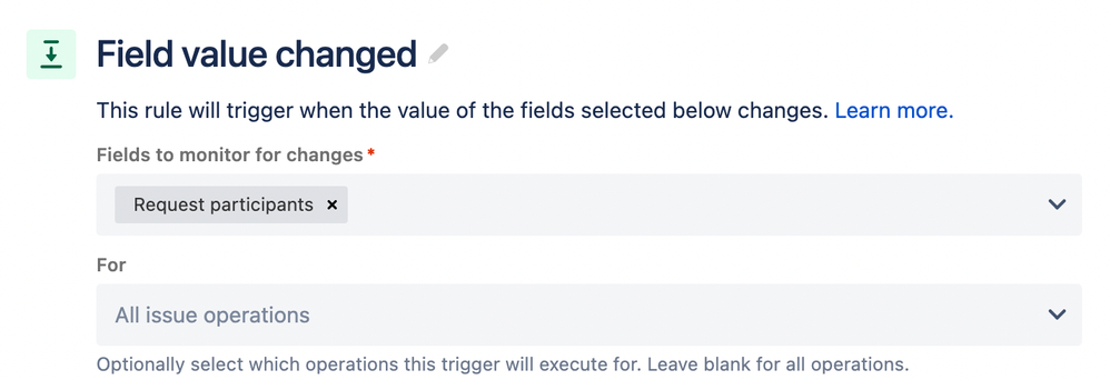

Fabian Lim
August 6, 2021
Hi @szymon_szostak
For the value changes trigger, did you set the operations to be for creation?
Regards
szymon_szostak August 8, 2021
It is set for all types of operations, so I guess it should catch it. I can see in the logs that it's triggered properly, but conditions are not met.
