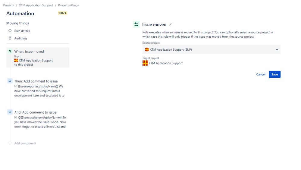

Hi
So within our flow sometimes agents will need to "move" one issue within the same project, changing only the type of the issue (e.g. question > bug). Now, I wanted to build an automation that upon such a movement will execute a number of things (e.g. comment on the issue).
The problem is, that the move action is not recognized as such. Instead a bunch of automation for "create issue" are triggering.
If I set conditions to "From any project to this one" and move the issue from another project, the automation fires off.
Do I miss something or do I simply not understand the logic behind the "move" automation?
Below is the automation rule:
4 votes

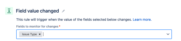

Hi @Jarosław Kaczmarek ,
I also don't know what the exact or correct operation of the Move Trigger is.
But maybe in your use case the trigger "Field value changed" with field "Issue type" is a better trigger.
Regards, Marco

Shelli Kleman
November 9, 2022
I am also curious to know what the logic is behind move, because I have the same automation setup to capture issue type changes, but it does not run if the project to and from are the same.
