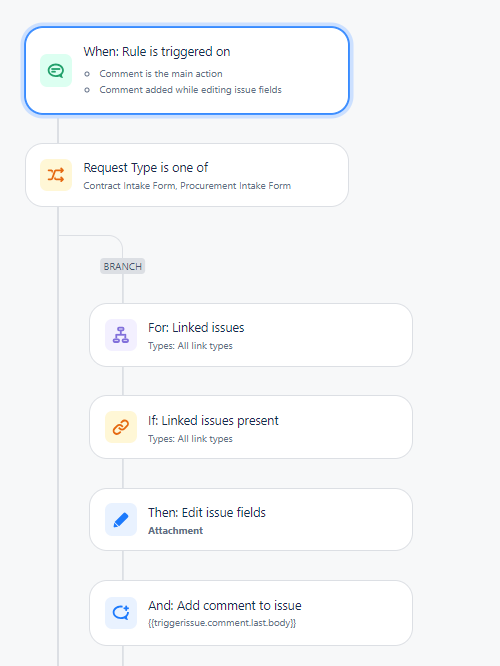

Here is my automation rule:

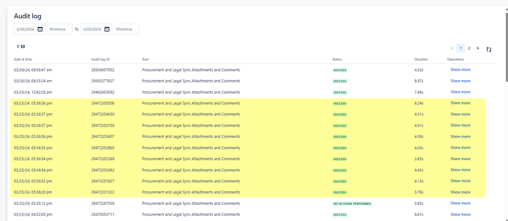

Here is the audit log showing where it ran repeatedly.

It appears from what I'm seeing in the audit log that the comment was made on project A (Procure project) and was not copied to project B (LDP project) because it didn't see the linked issue, even though there really was a linked issue.
Then it saw the issue and copied the comments from project A to project B.  Then it copied the comments back from project B to project A several times.
I do see other instances where No Actions Performed appear, but it does not copy the comments multiple times.  So I don't think that is the issue.

Well, I see a couple of things - why do you have a branch and then a condition right after it that does the same thing as the branch? The condition seems to be not needed. But that's not your real problem.
What I see is a rule that fires when you add a comment. Then you add that comment to linked issues. Which then causes the rule to fire all over again because you have added a comment. And since it has linked issues, it copies the comments back to the original ticket and it goes round and round like a dog chasing it's tail.

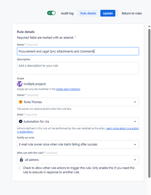

Can you share a screenshot of the Rule Details page?

Here is the rule detail

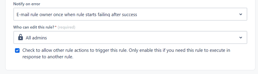

It's hard to tell why exactly this is happening, but can you check if this option is enabled by any chance?
Maybe the rule self-triggers based on its event?
