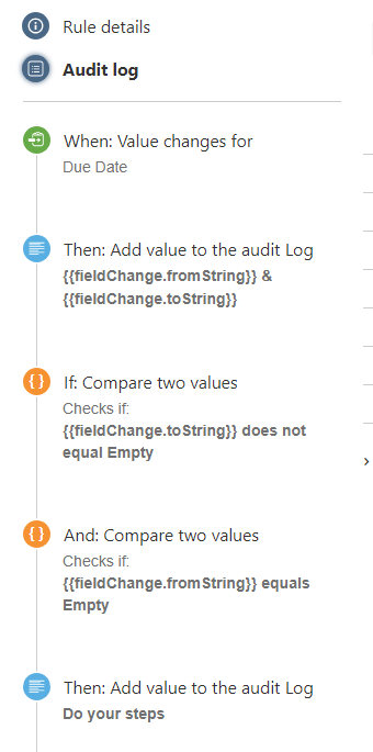

You could use {{fieldChange.fromString}} & {{fieldChange.toString}} to check if field was previously populated or not.
Below is a screenshot of Data center and cloud will look different but basic steps are the same.

@Kalyan Sattaluri Very helpful, thanks for sharing. I was able to create an automation that will only be triggered if the field changes after the first time it's populated by doing the following:
