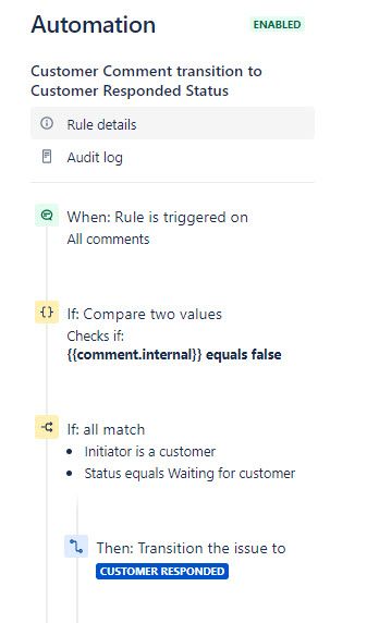

I have an automation to move the issue from Waiting for Customer to Customer Responded when the customer comments.  This should only happen when it's an external comment, from the customer.
My automation logic is as such:

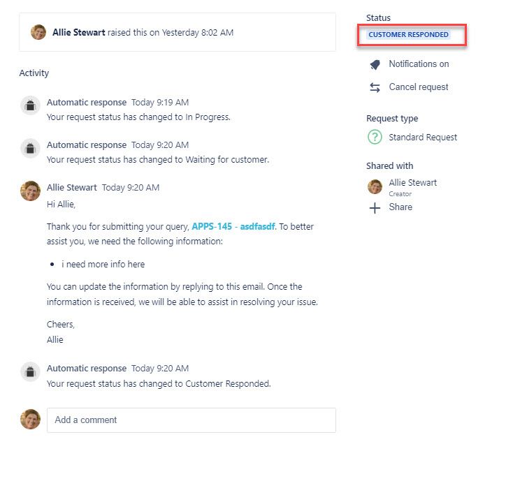

But what is happening is that when I use a canned response like "need more info from customer" and that performs an action to transition the issue to Waiting for Customer.... this automation seems to run and move the issue to Customer Responded immediately.
Is this perhaps because of the "automatic responses" maybe?  Are those considered external comments?  And maybe that is triggering the automation?

A few things to check first. Are you a participant on the issue? Or are you in an organisation in that service desk? If so, Automation might be thinking that you're a customer as well. You can probably easily setup a sample rule to test if that check is treating you as a customer?

Thanks Simeon.  I'm going to set up some test accounts for my org (that aren't ME) and I'll try it using those.  It is possible that because I am the admin, and the reporter, and the "all everything" in the system.. that the system is getting confused as to who is doing what.

Yes, that was the problem.  If your "customer" is also a licensed user, like a person at your own company that is not using Jira but only uses ServiceDesk portal, then the system takes their comments as internal.  That's going to be a challenge for us for sure.
