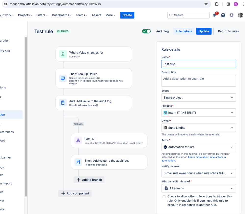

I am having problems with the following rule (the real rule is much larger, this is just a cut-down version to demonstrate the challenge):
The "Lookup issues" and "Log" actions are working as expected and finds and logs one issue. But the "For: JQL" action then reports no issues found which I find strange since it is the same JQL as in the "Lookup issues"-action. If I click on "For: JQL" action and use the validate JQL feature it does return one issue.
And to make it even more strange: If I change the trigger to "Manual" instead if "Field Value Changed" it works as expected: The "Log" action writes a line to the log.
The log for the two executions is here:
Any thoughts anyone?
Br, Sune

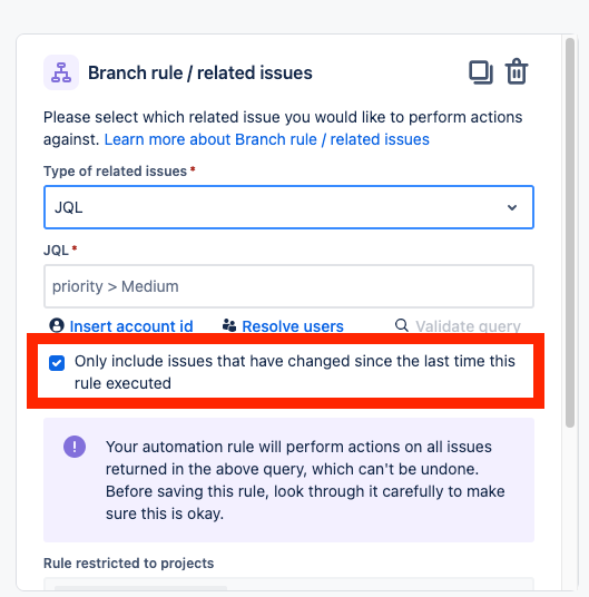

Is this box checked or unchecked in the For Branch?
