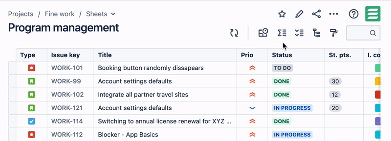

Hannes Obweger - JXL for Jira
August 20, 2023
Hi @Krishtee
I understand you are looking for a solution in plain Jira, but just for future reference if a Marketplace should become an option for you: This should be easy to do using the app that my team and I are working on, JXL for Jira.
JXL is a full-fledged spreadsheet/table view for your issues that allows viewing, inline-editing, sorting, and filtering by all your issue fields, much like you’d do in e.g. Excel or Google Sheets. It also comes with a number of advanced features, including support for configurable sum-ups, either across all issues of your sheet, or across groups of issues if you use JXL's issue hierarchy or issue grouping capabilities.
This is how it looks in action:
As you can see, this view is fully interactive, meaning that you can work on your issues directly in JXL (but also trigger various operations in Jira, or export your data to CSV or Excel in just a click).
