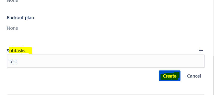

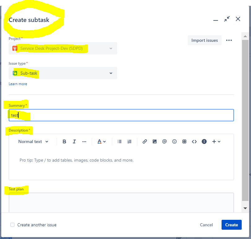

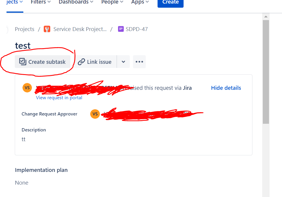

But my question is Once i create the change request i can see that "Create sub task"
I want to modify the fields of Subtask.
If i create subtask i want to my configured fields.
but i can see only three fields here.
