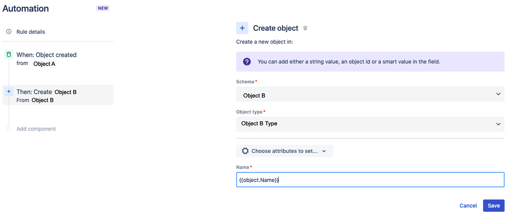

Here's one I put together real quick for when a new object is created:
You would need to add other attributes and for each you'd add the smart value {{object.attribute}} where attribute = the name of the attribute.

So would this Object B be identical to Object A but in a different schema? Also would i have to replace the "name" in that smart value?
Hi @Christopher Taylor - You could have them in the same schema, but my recommendation would be separate because by default, attribute pickers will show all attributes in the object schema. So, if you have duplicates, it's difficult to differentiate between what's on Object Type A vs Object Type B.
