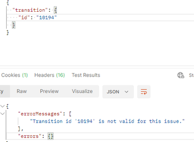

Hello, I'm trying to change the status of the Jira issue using postman, and I'm using the following URL: https://atlassian.net/rest/api/2/issue/{id o rissuekey}/transitions
Bu I'm getting the error:
    "errorMessages": [
        "Transition id '10194' is not valid for this issue."
    "errors": {}
I don't why I'm unable to perform the transition, also the 10194 is the Id for the status that I want to change, also i'm using the security token for the authorization, I map the Id using the: /rest/api/2/status and also the xml file

@Gerson Baires -
Welcome to the community.  You will have to review the WF setup in your project, to ensure that your current issue status do have an actual transition setup to the next status - where the transition object is your referenced ID.
Hope this helps.
Best, Joseph Chung Yin

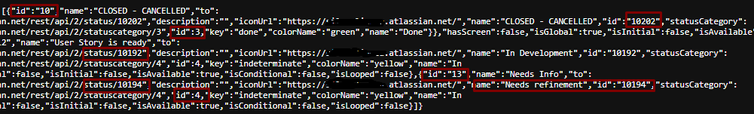

Gerson Baires August 15, 2022
Hi @Joseph Chung Yin thank you for the fast reply,  I was able to map the IDs, but where I can find those IDs in the Workflow? because I got confused with the status IDs since the: /rest/api/2/issue/{id o rissuekey}/transitions,  display different ones, for example, 10282 and the ones that worked are 10, 13.
Joseph Chung Yin
August 15, 2022
@Gerson Baires -
You will need to go to your project and access Project settings >> Workflows.  In the WF UI, identify the WF in question and click on Edit (pencil symbol) to check the WF -
Once in the WF configuration UI - you can toggle between the Diagram or Text mode to view the WF details.  In the Text mode, you will find all the transitions + their associate transition ID.  Those are the ID that you need to use.  NOTE - Each transition associated with a WF of a project, their ID can be different for the other projects.
In the Diagram mode, you will be able to see all the transitions from status to status in a visual mode.
Hope this helps.
Best, Joseph
