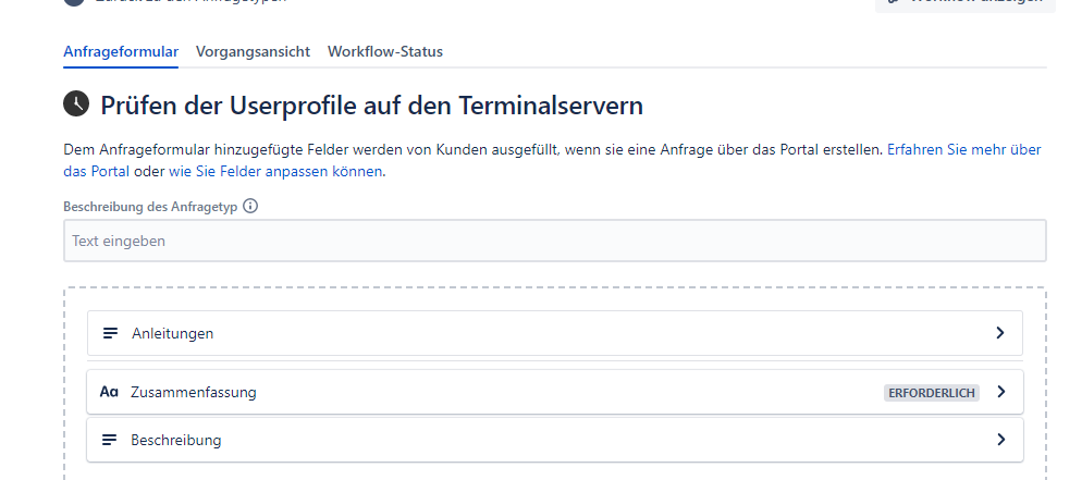

First the already created request type:

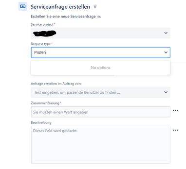

Now the automation
And now the search for the request type. Also not available in the dropdown when i dont search with letters.

Thank you for the added context.  So, if I'm understanding correctly, your project has more than 50 request types associated with it and you're thinking that because of this, you're not able to select the desired request type.
I haven't worked with projects having that many request types, but I believe the 50 count is only limiting what's displayed, not search.
Can you verify that the desired request type is available to associated with a portal group?

Philipp Schäfer October 27, 2022
Thank you for the hint.
Indeed this helped bring it up in the search. Now i can associate it with a portal group, create the automation and then clear it off the groups again and it works. (We dont want to show these request to the portal)
