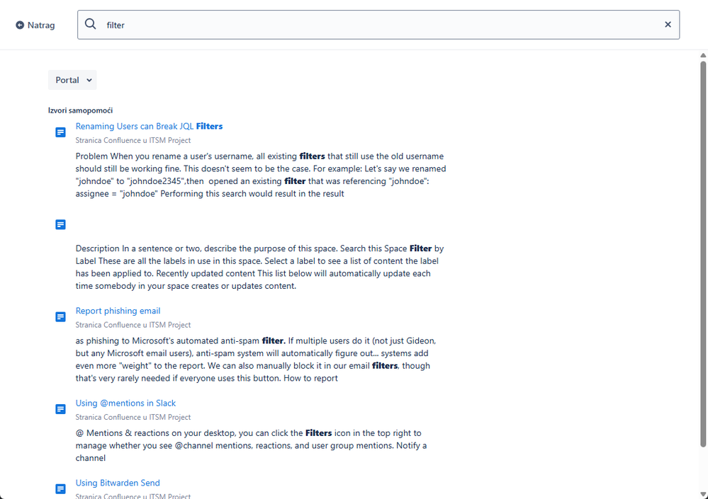

Could you also confirm whether the only way for customers to filter articles is by labeling each article with keywords — and that these keywords must be created and assigned by the administrator? Or is it possible to select labels independently, based on how the filtering system works with the web algorithm?
As for this, it depends. If we are talking about customer search, in the help center—those users cannot filter by anything other by keywords or phrases, which are then searched through KB titles and content. Basically, they cannot filter by labels.
Labels are primarily used when talking about 'connecting' JSM requests with specific articles that contain defined labels. More on that here: Set up article suggestions in request forms
The distinction between customers and agents is needed here to see which filtering we're talking about.
