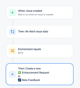

I want to develop a cross project automation where once an initiative is created in a Software project, if specific criteria are fulfilled, it will generate a story in a Service project. However, in this Service project, 'Request type' is required and the automation isn't able to generate because I'm not able to select the 'Request type.'
Are there any workarounds/solutions? Cross-project automation is enabled and this same automation has worked between Software projects. Thanks so much!

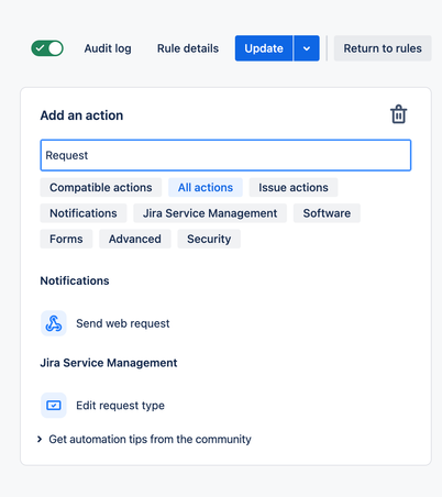

Do you have JSM permissions? As a Site / Org admin for my site, I can see both actions in the rule editor from JSM and Software projects.
Please post an image showing what you see when you select adding a rule component / action, and have selected All Actions.
Would you be able to share what you see @Bill Sheboy
Just want to make sure I have something to show the Owner in the unlikely scenario it's not there for them either. Thank you in advance!
My understanding is the rule editor has improved over time such that it now accounts for scope, permissions, and what is possible at a specific point in a rule's steps.
This is what I see with a global scope rule, which can be adjusted to be just your specific JSM and SW projects' scope.

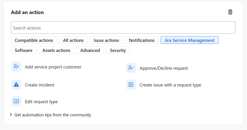

Thank you! To confirm, this can be done in a separate project from the trigger? E.g. the issue is created in a software project called "ASAP" and when an issue in ASAP is created and the Environment = Beta, it will generate a new story in the Service Project "BETA" and be able to determine this story's request type:
If the rule scope includes the service project and the actor has permissions, the action should be visible for use.
Thank you Bill! I got access to be a JSM Agent but it looks like the 'Create issue with a request type" action is only available in the Service project, not the Software project where we want the action to trigger from :(
Please note earlier I tried it from a Jira, global scope rule, and so it could "see" both Jira and JSM from there.
I hypothesize the improvements to limit / focus the actions in the rule editor cause this symptom as JPD does not have the problem (when permissions are sufficient): it only uses the Issue Create action for Idea issue types rather than a specialized one like JSM.

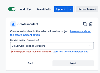

Thanks Bill! We looked into the 'Create an Incident' action instead and got a bit closer. Unfortunately, we're running into this error:

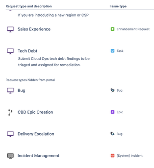

We added 'Incident' as an issue type and also created a request type for it.
However, in both the Software project and Service project automation, it says there's no request type for the incident. Any idea what we're doing wrong and how we can resolve this?
