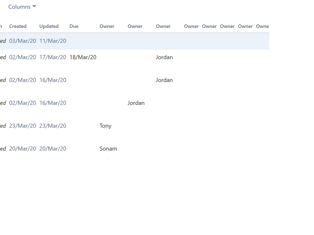

Susan, I have deleted the Owner1 and Owner2 fields which were not global.  I am down to the global Owner field.  Question I have.  Look at the picture below.  It shows an Owner field for each project.  Is that how a global custom field works - there is a column for each owner?  I was hoping that the Owner for each project was in the same field.  It makes it hard to do reporting across projects if the Owner custom field is in different columns.  Any thoughts?

Hi Brian,
Is the Owner a multi-user picker field?  Or Single-user picker field?
Susan
Brian Beard March 24, 2020
it is a Select List (multiple choices)
I have found that the Owner in one project is in one of the columns and the Owner in a different project is in a different column.  only one name was selected for each task on the project.
Susan Hauth _Jira Queen_
March 24, 2020
So when you export a custom field that is multi-select you will get that multiple column view as Jira is trying to show you all the values that were selected per issue.

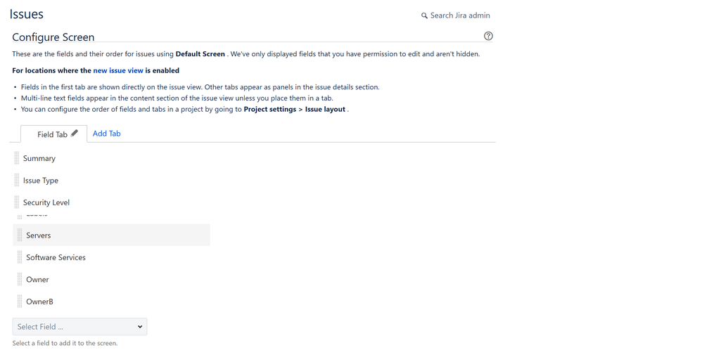

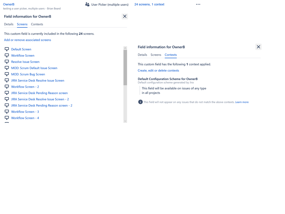

I created a new global custom field named OwnerB.  I then added it to all of the available screens.  When I go into a project and try to add the new field to the Task, the new field is not listed.  I have also noticed that I don't have the "Search Fields" that another person has right above the "Time Tracking".  I am an Administrator in Jira and I also gave myself Administrator access to this project.  Do you know why I wouldn't have this option and be able to select my new field?Jira2.png

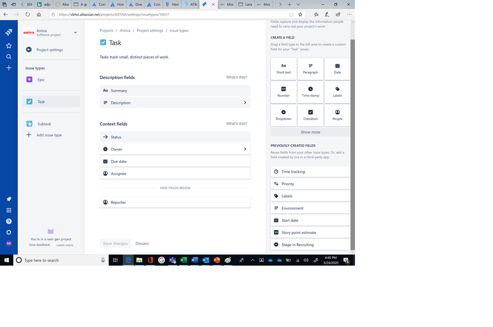

I created an issue and I don't see it.  I am using the cloud version so this is new to me.  In the past I used an on-prem solution which looked different.  I have very few fields on an issue in the cloud version.  not sure if that is normal.  giving me a headache!
for whatever reason I can't get the Global custom field to be seen on any type of issue.  Should I repost this?  i am not sure what else to do.
i do see the OwnerB field in the Screen configuration when I look at the layout...just can't add it and I never see it on a screen.
March 25, 2020
So I see OwnerB on the "default screen". But It's not apparent to me that Astiva is using the default screen scheme?  Because you don't see OwnerB in the Task screen in project Astiva.  I'm not a huge cloud user,
Is Astiva a next-gen project?  That might be a factor and I confess I don't use next-gen (find it far too limiting)
Susan
Brian Beard March 25, 2020
it is a next-gen project.  this whole screen thing is new to me and I am not used to it.  The OwnerB is in all 24 screens listed so that is why I don't understand why I don't see it.

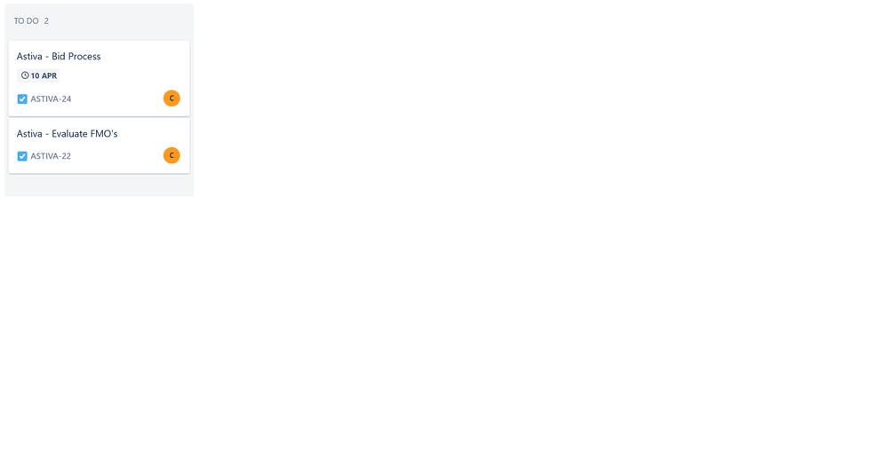

I will maybe create a couple of Classic projects and see if it works the way I need it too.  thanks for the help...you too Susan.  One last question and I think I already know the answer.  My user wants to know if we an edit the way the task is shown in a board.  I think the answer is no because I can't find anywhere or any documentation that says you can.  see screen shot.  My user wants to add the Owner field to this...not sure that can be done.Jira6.png
Mikael Sandberg
March 25, 2020
You are correct, in a next-gen project you cannot change what is being displayed on the board. This can only be done if you are using a classic project.
