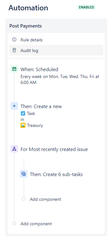

I have a couple automations in a JSM project that create a task and then add subtasks to that most recently created issue. I am receiving the following error:
Create subtasks
Some sub-tasks could not be created:
1: The issue type selected is invalid. (issuetype), Issues with this Issue Type must be created in the same project as the parent. (project), 2: The issue type selected is invalid. (issuetype), Issues with this Issue Type must be created in the same project as the parent. (project), 3: The issue type selected is invalid. (issuetype), Issues with this Issue Type must be created in the same project as the parent. (project), 4: The issue type selected is invalid. (issuetype), Issues with this Issue Type must be created in the same project as the parent. (project), 5: The issue type selected is invalid. (issuetype), Issues with this Issue Type must be created in the same project as the parent. (project), 6: The issue type selected is invalid. (issuetype), Issues with this Issue Type must be created in the same project as the parent. (project)

Here is the automation example:

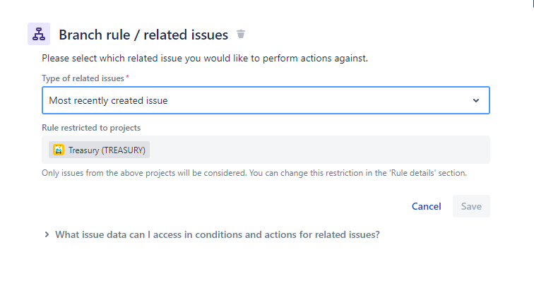

@Joseph Chung Yin @Kai Becker I'm on the cloud version, so I think mine might look different. Here is what sub-task creation looks like:
The branching rule for most recently created issue typically has worked to link the sub-tasks to the created task similar to how yours works in your screenshot.

I'm a little confused why your automation says "Create 6 sub-tasks".
It should be listed as individual Sub-tasks. I'm not sure if this is an issue between Standard vs Premium.
Kai Becker
February 23, 2023
@Suzi Firth thats actually normal if you do not enter additional field values for the sub tasks.

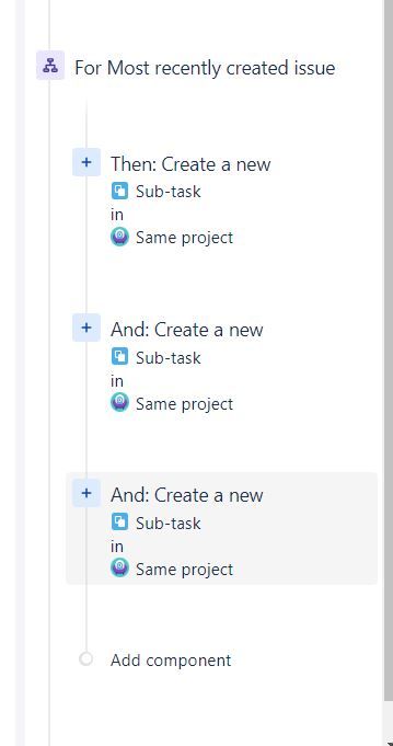

Suzi Firth
February 26, 2023
@Kai Becker oh that's interesting. I see the difference now.
You chose the "Create Sub-tasks" action where as I had used "Create Issue" action and then selected  "Sub-task" in the Issue type drop down.
Two ways of achieving the same thing.

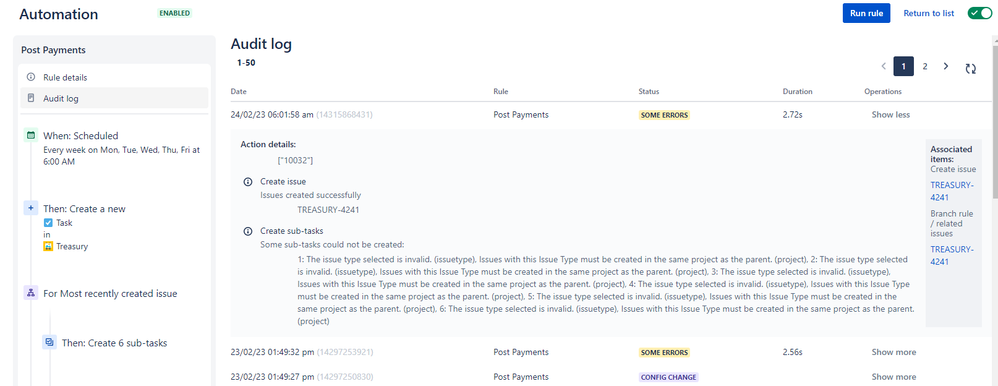

from your screenshots and explanations, everything looks ok. Could you please add a screenshot of the audit log of the rule and the sub task part?
I would like to reproduce this.
Amelia Giuliani
February 24, 2023
Here is the audit log:
It is creating the main task so I know that up to that point it's ok.
