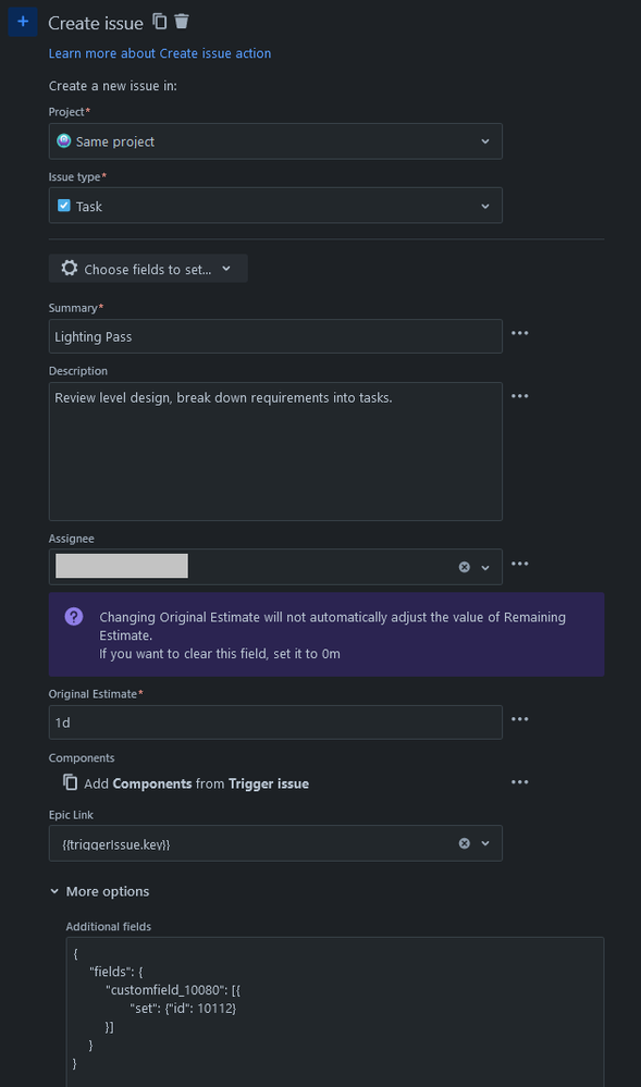

I have set up this JSON:
"fields": {
"customfield_10080": [{
"set": {"id": 10124}
And it seems like it would work if not for that field being required. This is the error that it throws:
Error creating issue
    Team is required. (customfield_10080)
Now, as seen above, this field is obviously being filled. I have tried replacing "fields" with "update", but then it throws an error about needing to be in an array format. I have tried removing the "set":, but it throws an error about JSON formatting.
Is this simply not an option in the current state of Jira Cloud? Or am I just setting these fields incorrectly? Thanks for any future help on this.

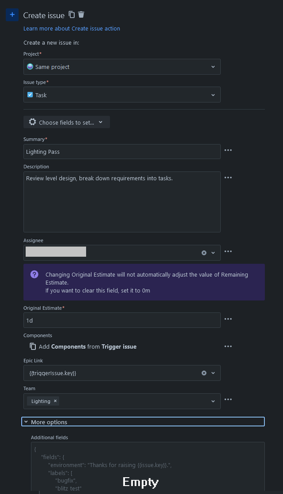

The Automation is a manual trigger intended to be used on an Epic. It has 5 "Create Issue" actions. Each one looks basically like this now: imageThis is how that automation looks without Additional fields, and works:
This is the automation log, with labels for when certain changes are made:
