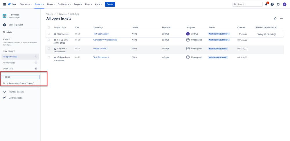

How to make a filter on JSM dashboard, that no one else can see..except the assigne ?
i tried to make a filter. but, the other's still can see my task on dashboard.

hi @Joseph Chung Yin ,
thanks for the respon.
so.. each agent have a private view ? if i apply settings like you said.
because, i have 1 custom field called "SITE" and each site have a different agent.
