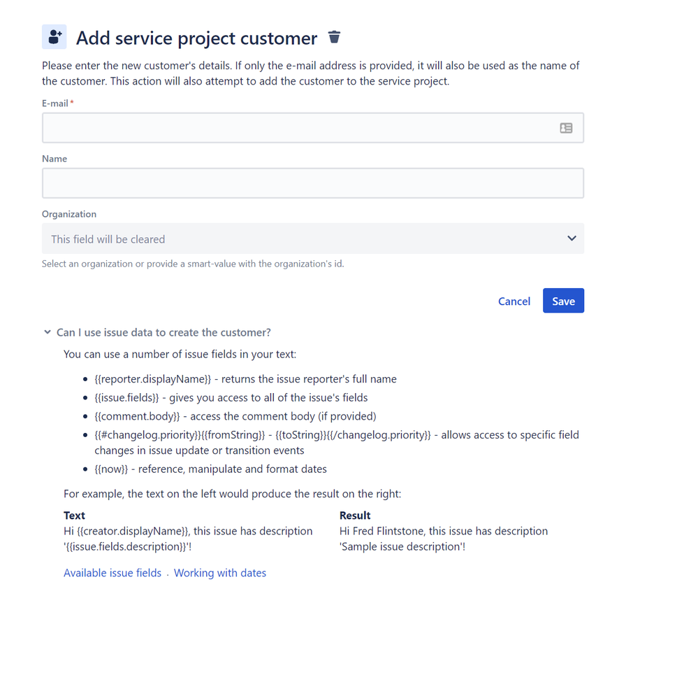

I want to use Automation to Add the Email/Name from my custom fields "User's Email Address" and "User's First Name" to create the Customer in Service Desk using the inbuilt functionality of Automation but the page I am seeing below is not ringing any bells for me. The email would be different everytime, should I be using the smartvalue of the email field?

Hello @JayJuan Jones,
Your assumption is correct. In order to add the customer, since every time the automation runs, it will add a new customer, on the E-mail field, it’s necessary to add the smart value of the field you created. So the automation will read this field and will invite the customer. This is also true for the Name field.

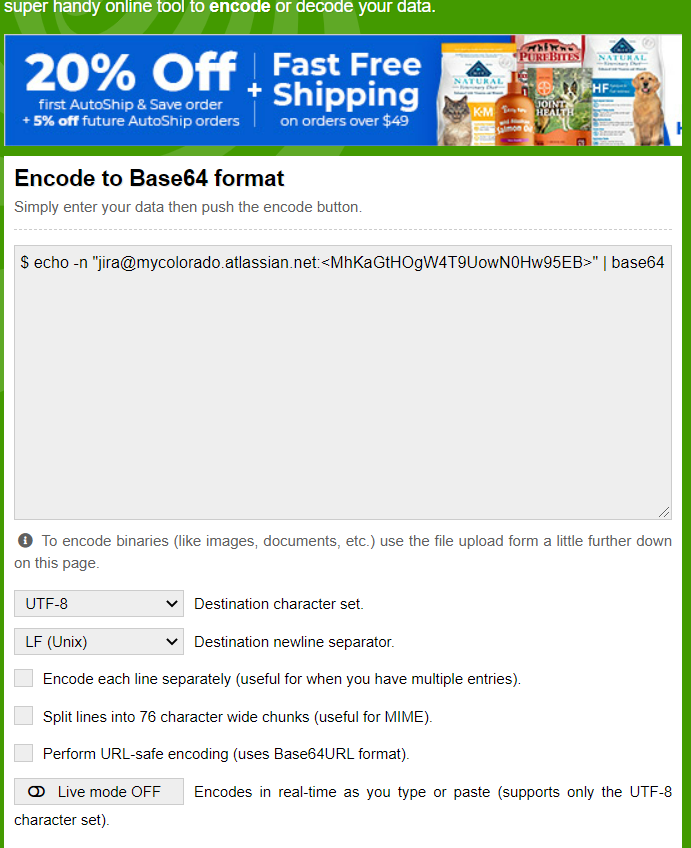

@Angélica Luz okay so I have a question about the encoding of the API, is this a command I can run in the command prompt? If so, would I be replacing "email@domain.com" with my servicedesk email?
This is what I used based on the documentation provided from the link:
$ echo -n "jira@mycolorado.atlassian.net:<MhKaGtHOgW4T9UowN0Hw95EB>" | base64
and here is the output:
JCBlY2hvIC1uICJqaXJhQG15Y29sb3JhZG8uYXRsYXNzaWFuLm5ldDo8TWhLYUd0SE9nVzRUOVVvd04wSHc5NUVCPiIgfCBiYXNlNjQKCg==
should the line above be going into the Headers field next to the Authorization textbox? And if so, do I need to keep the word "Basic"?

It’s necessary to use the email address where you generated the API, in this case, your Atlassian account.
Is this a command I can run in the command prompt?
Yes, you can generate it on the token on the terminal or on the tool they mentioned in the article.
Should the line above be going into the Headers field next to the Authorization textbox? And if so, do I need to keep the word "Basic"?
Yes, keep the “Basic” and add the token after that, just leave a space between Basic and the token.
