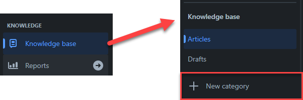

I just found out where we can remove this.
So, it's simpler than I imagined.
Inside the Project, I went to "Knowledge Base".
There is shows the Categories created for this project's knowledge base.
On mine, I had some that were created by someone, and they were being displayed on my Customer's Portal.
After deleting the categories, the portal is displayed normally, now, without the "Learn more about" box.
Thanks for your attention!

Hi @Gustavo Moraes ,
if you do the following the "learn more about" should disappear:
Hi, Jack!
