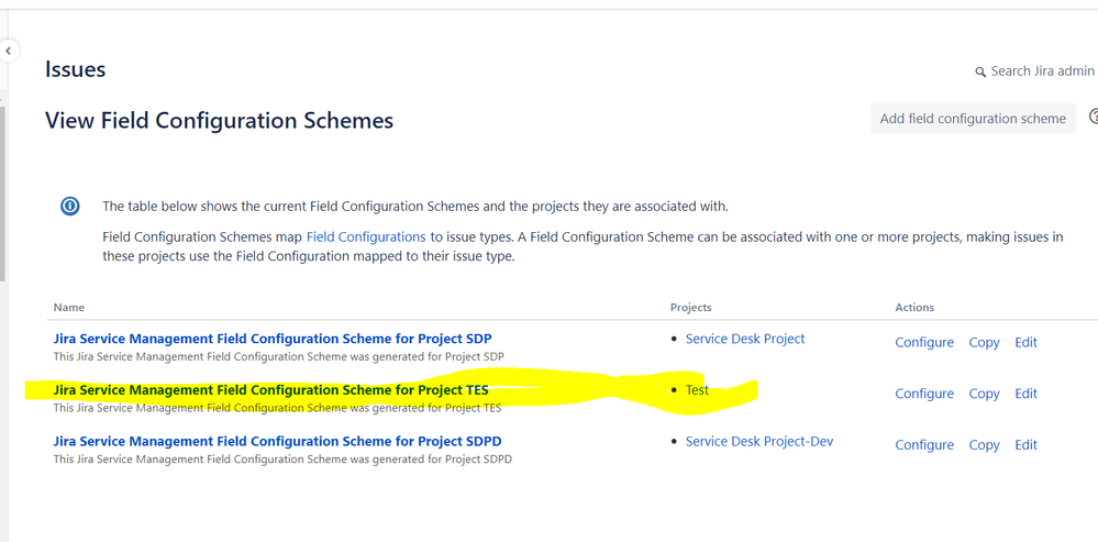

Ignore the field configuration for a minute. Go to the field configuration scheme list - do you have "delete" on any of the schemes? Most importantly, does the one "for project TES" (not TEST, TES, as in your screenshot) have an option to delete?
If so, delete it, and then go back to try to delete the field configuration you're trying to get rid of.
If it does not, then you'll be able to see what projects are still using it (and hence preventing your deletions)
Hi @Sreenadh
The reason why you are unable to delete that Field Configuration scheme is because it is still associated with the Test project.
You can only delete a scheme that is not associated with any projects.
Once you disassociate that scheme, then you can follow these steps to delete the scheme.

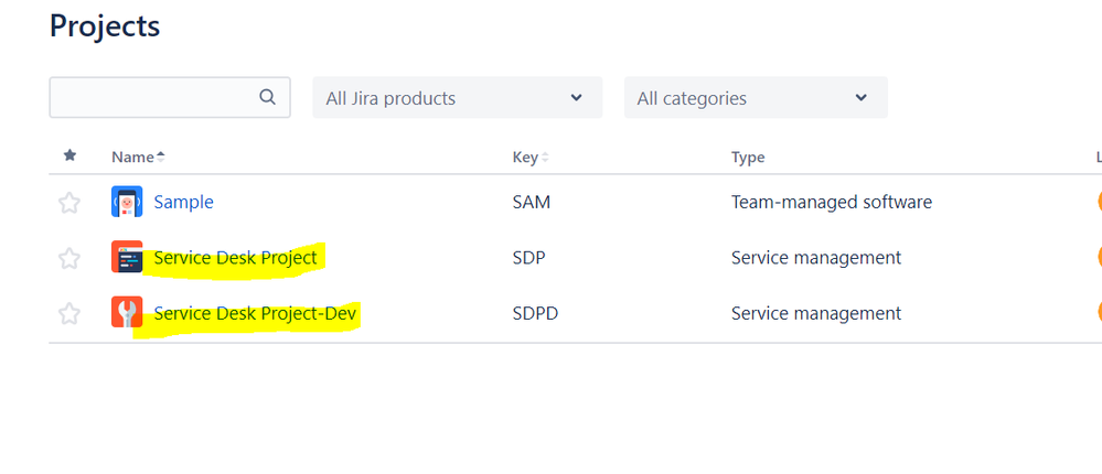

I have deleted the project Permanently but still i can see the Schema.
Please find the attached screenshots for your reference.
Hey @Sreenadh
That screenshot shows me a list of projects with highlights of two service management projects. I'm not sure why that's relevant, since once you have deleted a project it should not be showing up in either the list of projects view or the trash.
Can you go into your Projects > Trash. See if the test project is there or not.
That's where you are able to permanently delete the project.

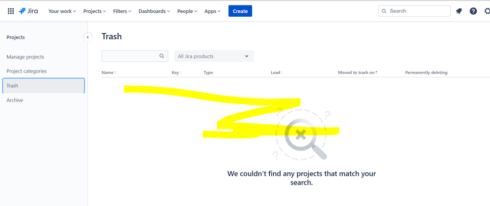

I have checked in the Trash as well but still i am not having the option to delete the same.
Please find the attached screenshots.

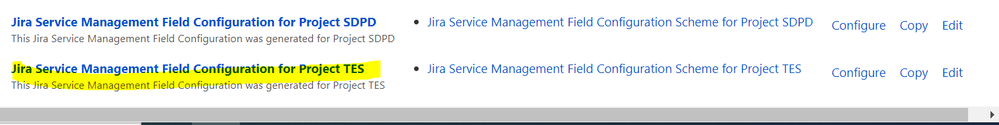

Ok, so you permanently deleted the Test project. Can you send me the screenshot of this page again? Does it not give you the "Delete" option next to the "edit" option for this yellow highlighted Field Configuration Scheme?
Sure,
Here it is
That isn't the screenshot for the Field Configuration Scheme (like I mentioned above). It's for the Field Configuration.
Once you go into your Field Configuration Schemes you'll be able to locate the Jira Service Management Field Configuration Scheme for Project TEST and have the ability to delete it.
Once you've deleted the Scheme then you can go back and delete the field configuration (i.e. the screenshot you posted in your last comment).
