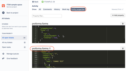

@Ryan Wolfe thanks for your question. As noted there is no formal support for accessing the form entity property directly; however, the data is still there and you can use the steps above to access it.
We will bring support to Automation for Jira to access form contents with SmartValues; however, it is not yet available.
In the meantime you can use the Entity Property Tool for Jira to be able to inspect the form data. This should allow you to continue to build your automations.
Again, this work is not officially supported, so please be careful how you work with these properties as you can easily break a form by changing the JSON.
A few screenshots to show you how to access the data.

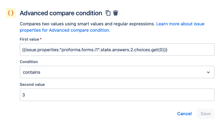

This is the smart value from my form:
{{issue.properties."proforma.forms.i1".state.answers.2.choices.get(0)}}
It does return a value when I set the condition to contains instead of equals.
I found another community article that changed out the pf-1-cd-2 id for just 2 as in my updated example above.
My automation is now working great!
