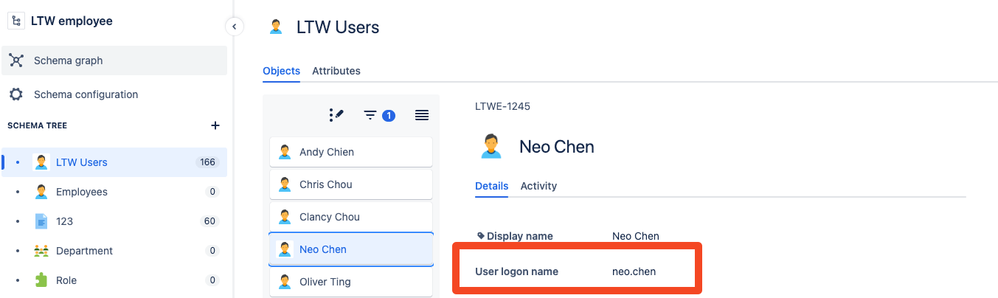

I want to get the data Attributes from assets, how do I write them in automation?

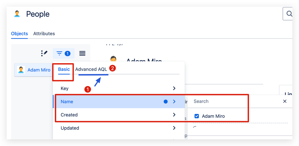

Hi @Wayne Yang
Welcome to our community.
There's a tip to query your result through Basic search and then switch to Advanced AQL. You will get what you want.image.png
Hope it helps,
