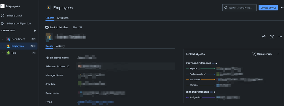

I have some issue to add the users manager as approver in the issue the user opened. I found here some guides and be trying some hours but have no lock. My situation looks the following:
have tried already from this guides:
Finding managers of users and setting them as approvers automatically - Web Site - Confluence

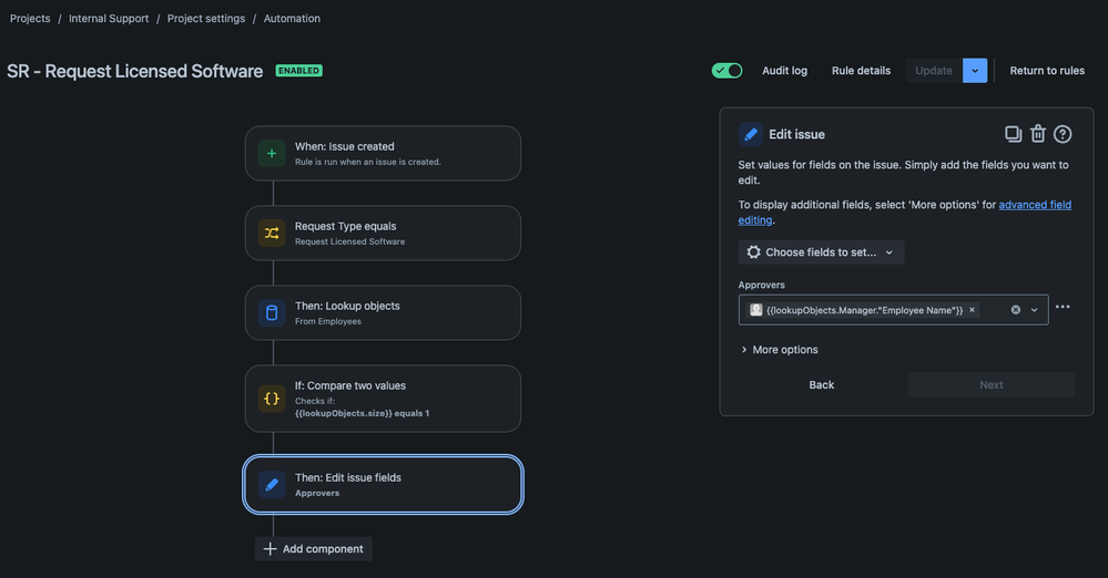

My automation looks actually:
my workflow for the approver is in place but in this case i need to use for each request the users manager to add him as approver.
From my automation the first part til and with extracting the reporters email address is working fine. The Audit log shows each time an success but the manager (i think) is not found and not entered in the issue as approver.
Thank you in advance

You'll need to fill the user picker field with the accountId of a Jira user. Looking at your screens this would be something along
{{lookupObjects.Manager Name.Atlassian Account ID.accountId}}
As Valerie rightfully suggests, get the input values in a Log action, so you can review what happens in your rule's audit log.

Hi @JZD , thanks for your post.
Please can you try putting a 'log' action before the 'edit issue' action and put the smart value you want to populate the edit issue action with?
When you try to run the rule again and check in the audit log, you should be able to verify if the correct value is being 'printed' into the log and then, if it's not, then we can try to understand why.
@Valerie Knapp Thank you very much for your answer
I tried now with the log action but receive no output from my value except the mail address in the first step
Breakup your smart value to troubleshoot, i.e. {{lookupObjects}} then {{lookupObjects.Manager}} then {{lookupObjects.Manager.Employee Name}}, but also have a look at my comment above :)
