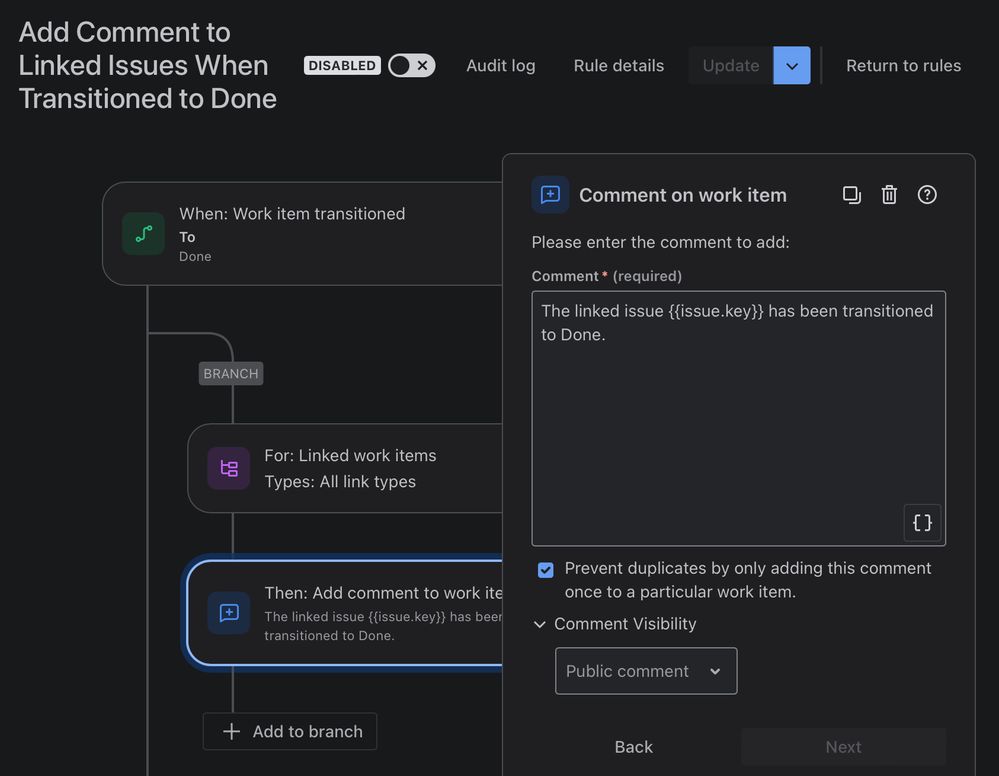

Hi @Satu Rajala ,
below is a basic solution to your request. However, you will want to add the necessary conditions so that the action is only performed when needed. This will be a multi project rule which includes your JSM and your development projects.
here are some suggested conditions to consider.
  • project = development project ... this will ensure that the rule is uni-directional, I.e. you don't add comments to the dev project when the JSM issue is closed
  • Type = bug ... assuming only bugs are to result in comment
if you can build out your rule then, if you have further questions post a screenshot with questions I will do what I can to assist further.
Jack Brickey
May 26, 2025
Oh, and you may want to specify the linktype in the "for: linked work items" component to only action the desired linked issues.
