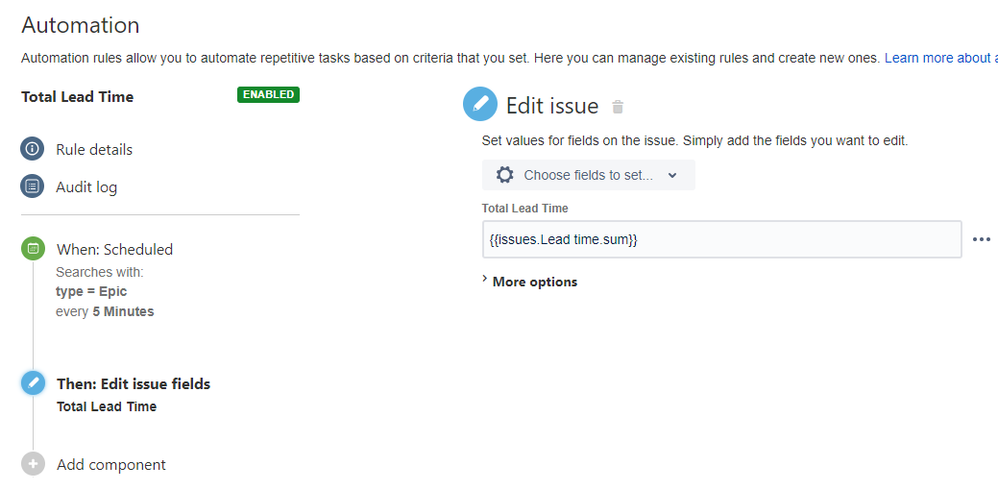

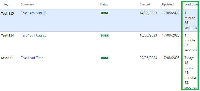

I have a custom field "Lead time", where i'm calculating the difference between field Created and Updated.
Please find below my automation:
This rule works correctly and is outputting the result in my dashboard:
Next, I want to calculate the sum of all the values from field Lead time. For that, I have created another custom field "Total Lead Time".
For example: Total Lead Time = 1 minute 35 seconds + 1 minute 57 seconds + 7 days 18 hours 44 minutes 13 seconds
My automation is as follows:
But, when this rule is trigerred, I'm not getting any result in the dashboard (column Total Lead Time).
Can you please advise what is wrong?
Thanks.
Hi @Krishtee,
I'm not sure if it's even possible to sum up such values. {{issue.created.diff(issue.updated)}} returns a string, but only numbers can be summed up.
Anyway, I'd recommend you to create another question so other community users can advise you on it.

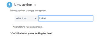

Hi Krishtee,
To calculate the number of tickets you have to run a jql query inside the rule with lookup issues action and then use smart value {{lookupIssues.size}}.
You can see the example on my screenshot below:
Hope this helps!
Thanks for helping.
But I don't have the "lookup issue" feature available.
Can you please advise how to proceed?
@Alisa Zamaraeva, it looks like @Krishtee's using Jira Server/Data Center. Lookup issues is available only for Jira Cloud.
Good answer though!
