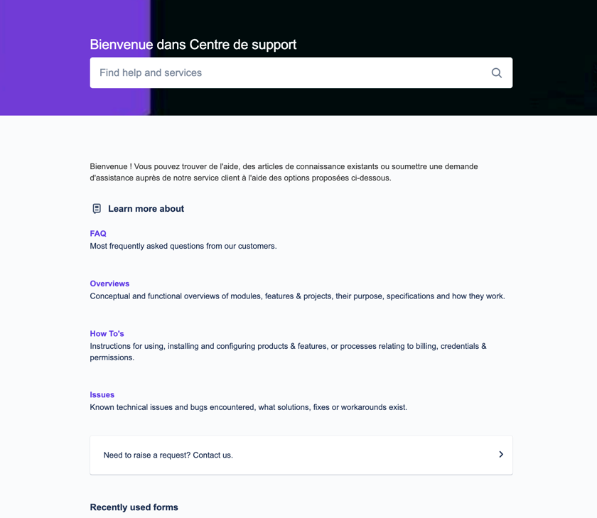

Olivier Pathy
March 16, 2022
Hi @Alessandro Distefano,
With your app, is it possible to:
  1. Translate the Knowledge Base Articles AND the Article Categories in Jira, so that
  2. The entire content appears in the target language on the JSM portal?
Attached below is an example of what the user experience is at present, a very unsatisfactory jumbled mess...
March 16, 2022
Hi @Olivier Pathy
Unfortunately, as others have also said, what you are trying to achieve is not currently feasible due to several technical limitations.
The best solution in your case is probably to create a separate portal for each language you wish to support.

Olivier Pathy
March 16, 2022
SO, to be clear, you are saying:
  1. It is NOT possible to localise the categories?
    • Please note that the categories is how the knowledge base is displayed and sorted on the JSM portal, hence non-English speakers will not understand this content
  2. It is NOT possible to display ONLY the translated articles?
    • Hence the content will be displayed in a jumbled mix of languages for ALL users how access the JSM portal?
Oli
Mattia _bitvoodoo ag_
March 16, 2022
1) Our app does not offer the option to localise categories in JSM as it is a Confluence app.
2) In the case of our app, the content of the article is automatically displayed in the prefered language of the visitor. So it is localised. But the title of the article can't be translated and therefore will keep the original title.
Atlassian does not provide this localization. Therefore, as I said, check if for your use case one of the other app vendors, where one article is created per language, can automatically output the article in the desired language based on the user browser or account preference.
Olivier Pathy
March 16, 2022
Ok thanks for the clarification and for your help.
