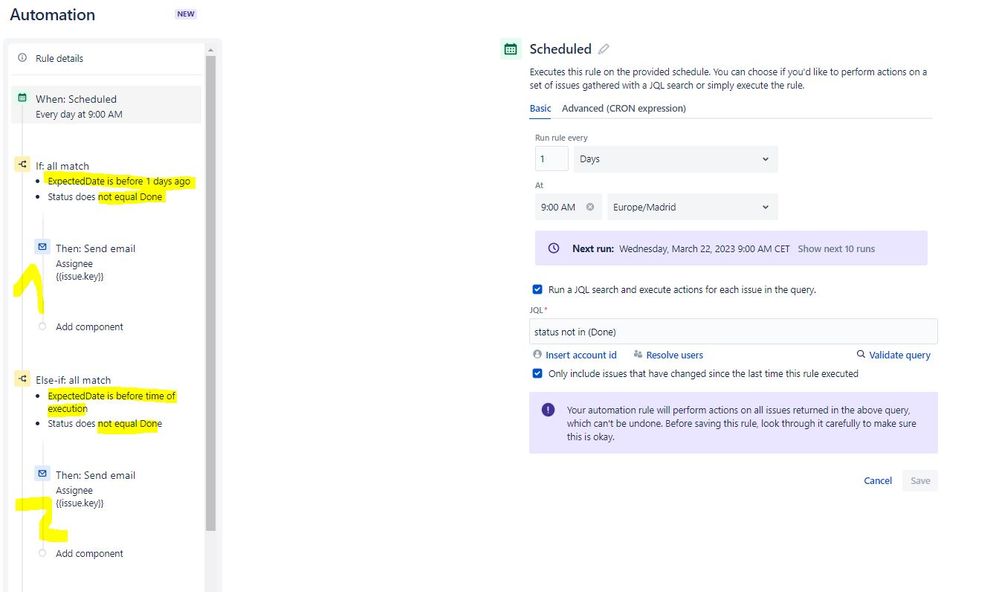

Juan Carlos Vera
March 21, 2023
Hi @serge calderara
ok, then i undestand that the advise is only for not DONE issues.
Can you try with something like this automation:
Regards ;)
serge calderara
March 21, 2023
hello @Juan Carlos Vera I have few question :
Sorry I think there are misunderstanding sorry for that and let me explain again
What I need to do is the following :
  • Build a JQL which Select all issue where the ExpectedDate field is 1 day from now
  • Then send an email which display in email body the jql result of all issue linked
Does your if All Match condition does that ? I could not replicated as I do nor see the condition type you setup ( screnshot might help?
How to read back then in email the list of issue return ?
Regards
